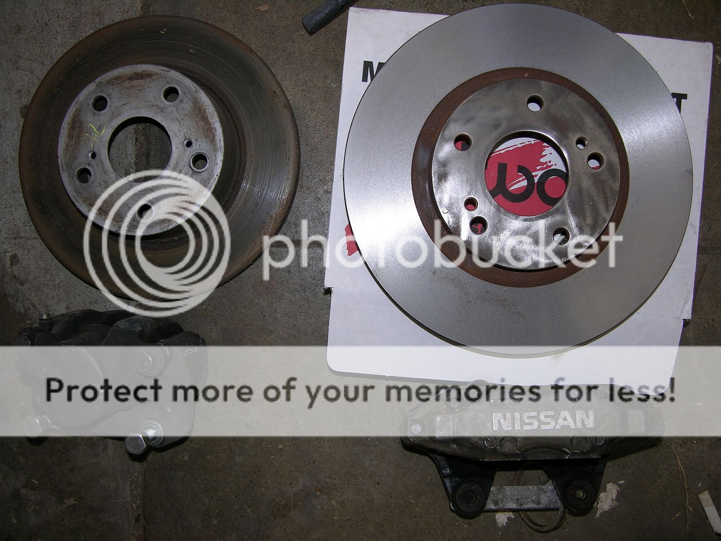

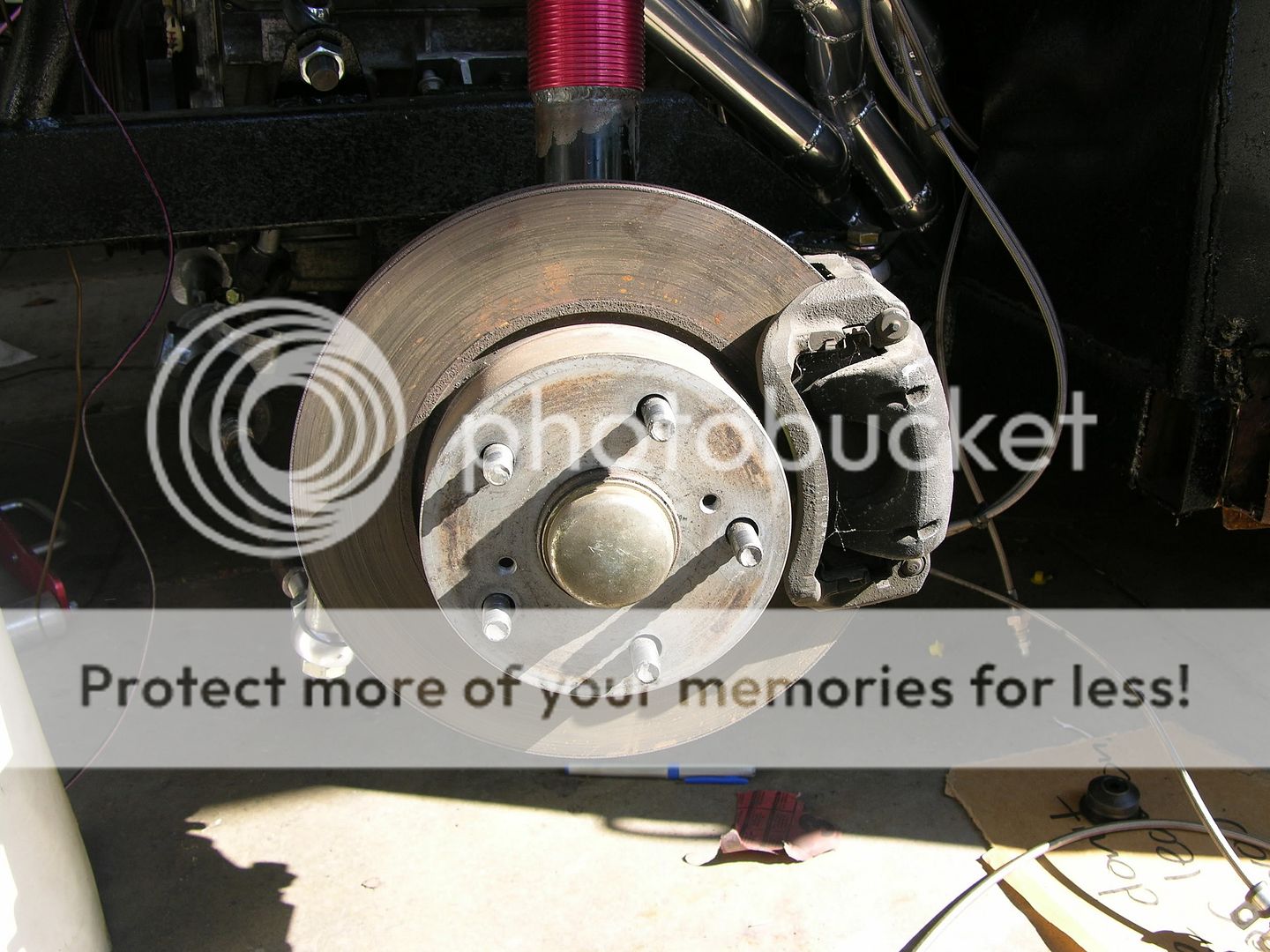

Brakes - old on the left, upgrade on the right

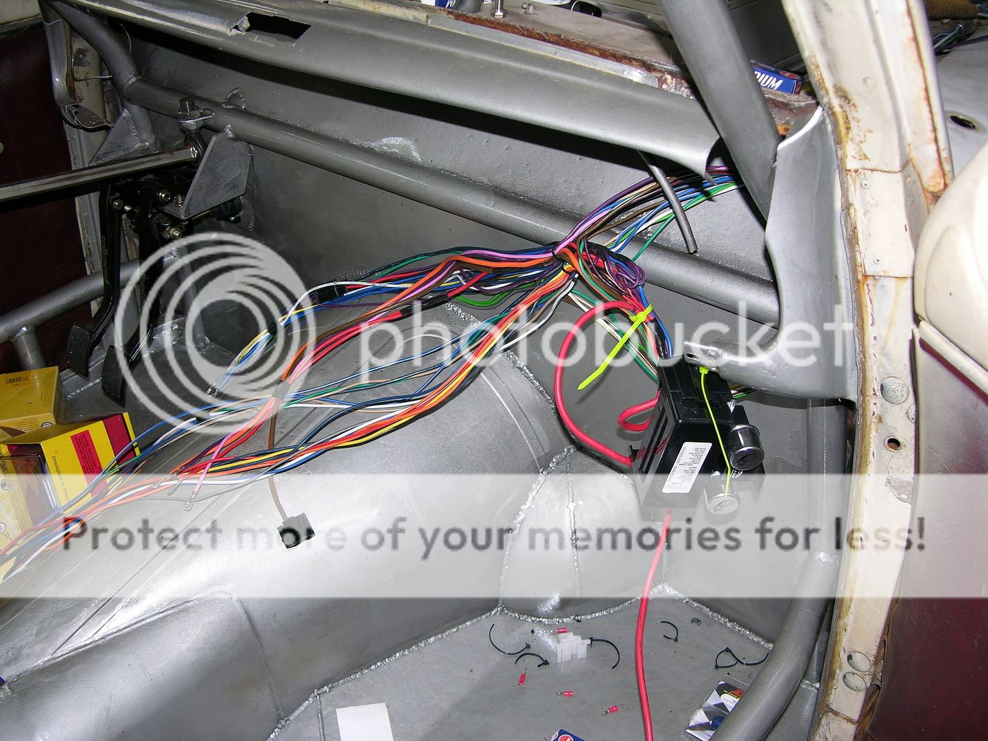

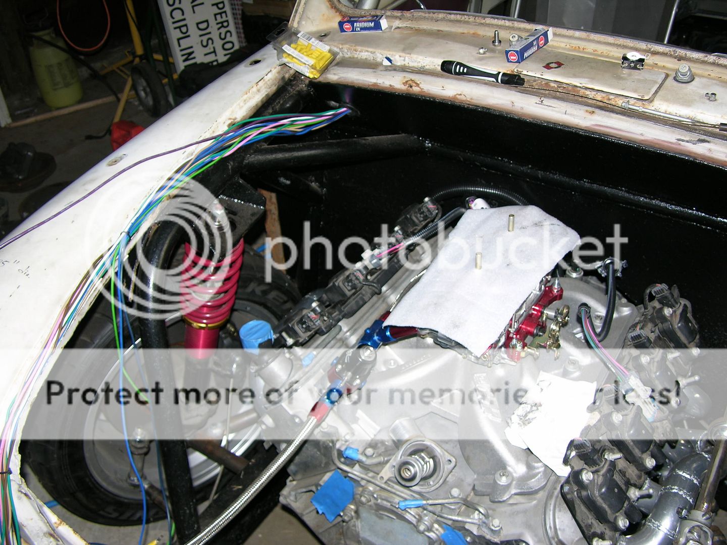

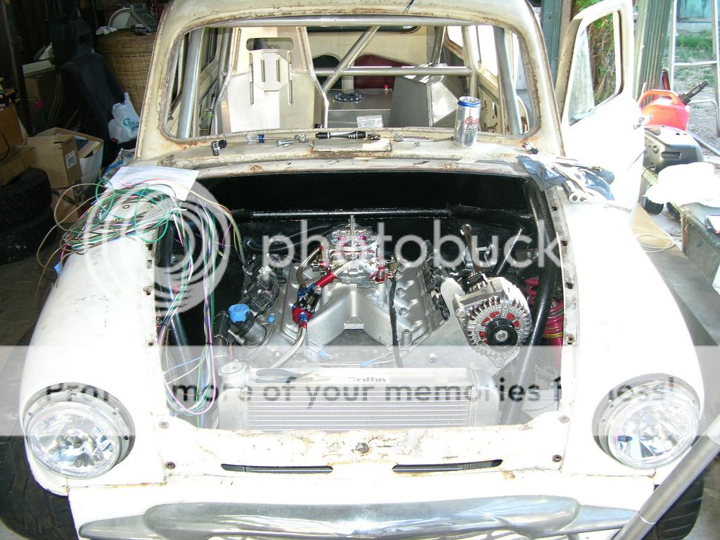

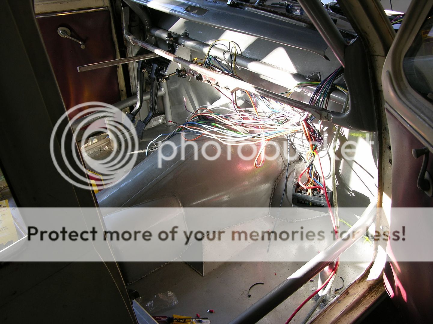

Wiring...ICK

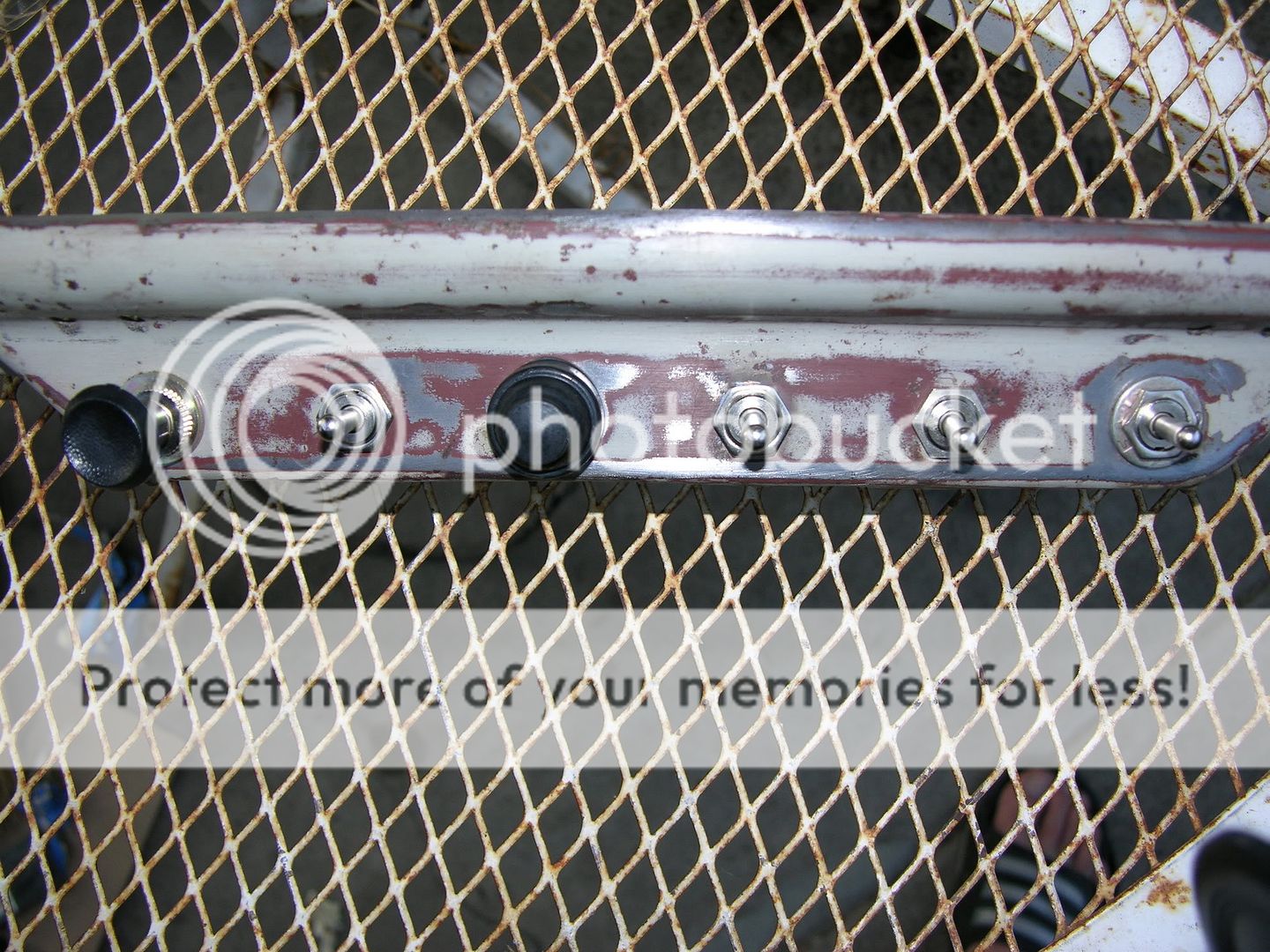

Original part of dash, re-used for new switches.

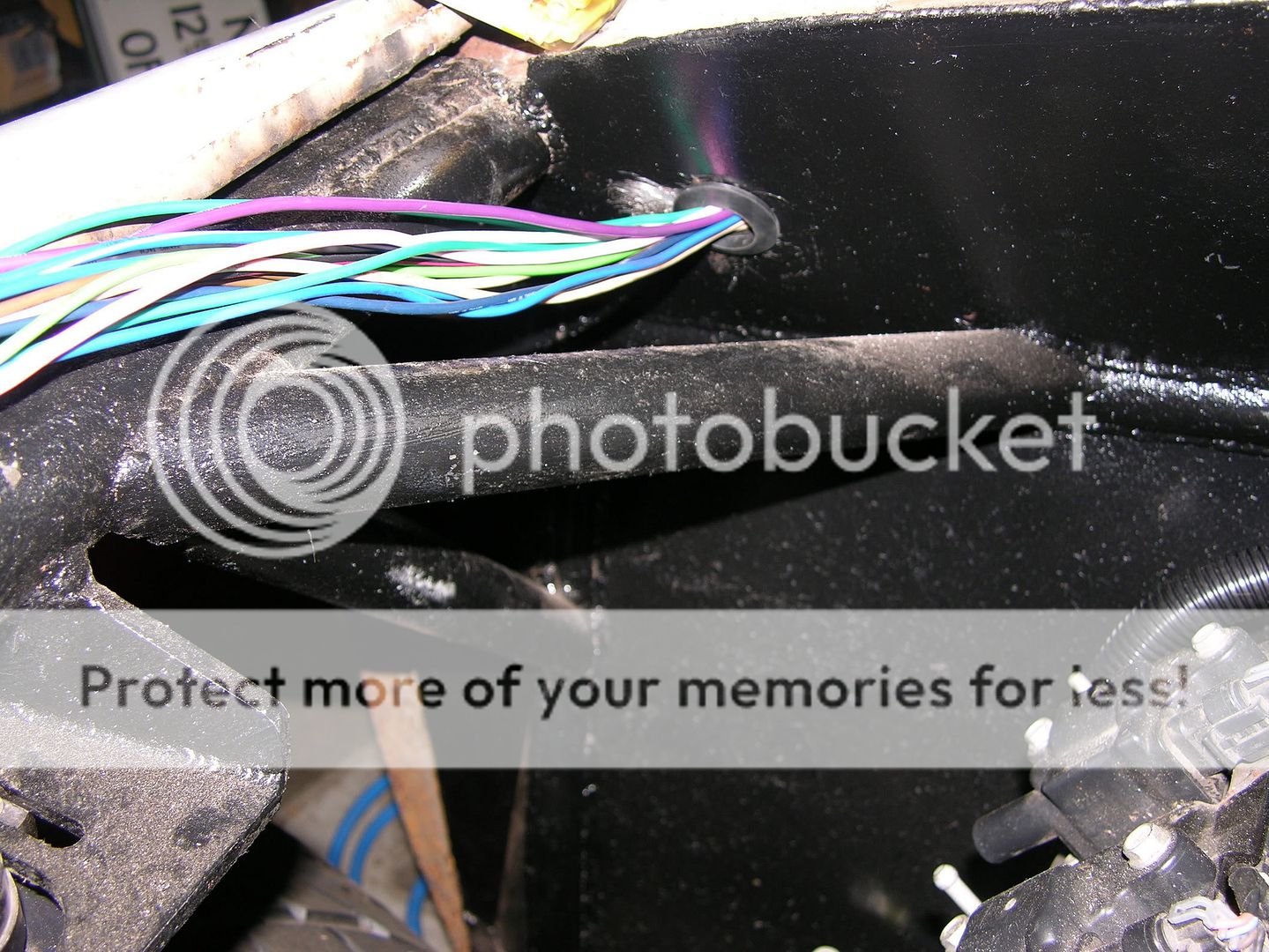

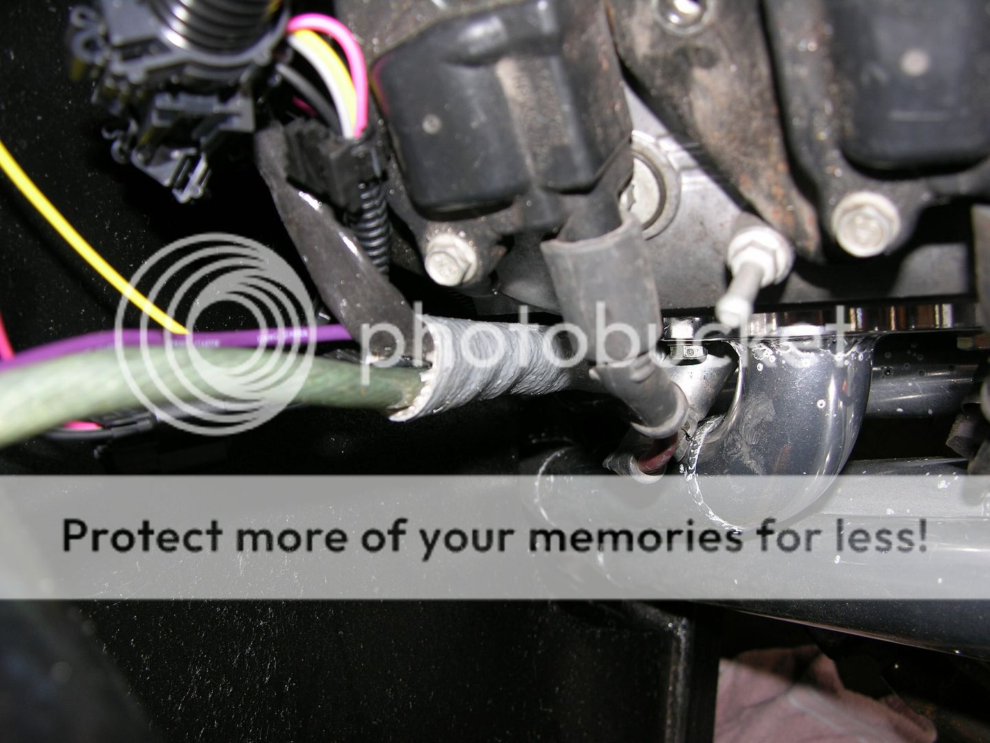

Wires coming through the firewall:

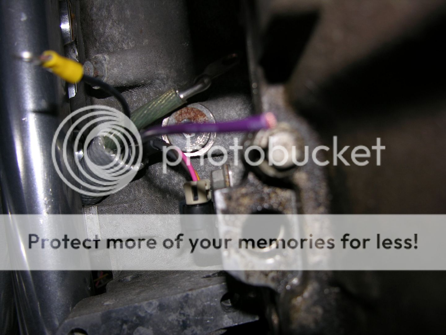

Starter/sensor wires in high temp sleeve:

IT looks messy, but it's progress!

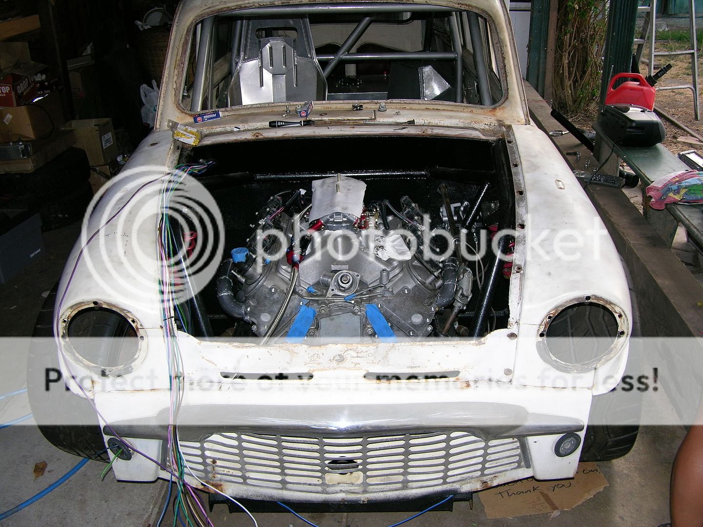

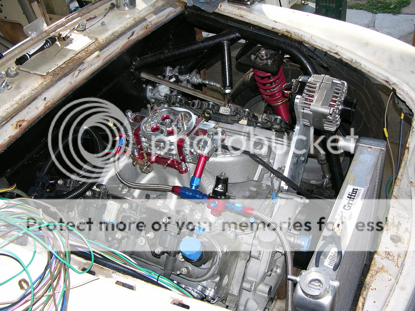

It's straight headers now, but i don't know how much quieter it will be with the mufflers on it.
Today, i started it up in the backyard, revved it to 3500 a couple times, and shut it down. Within 3 or 4 minutes, my neighbor from 4 houses down (who was inside his house when i was running the engine), came over and told me how great it sounded!

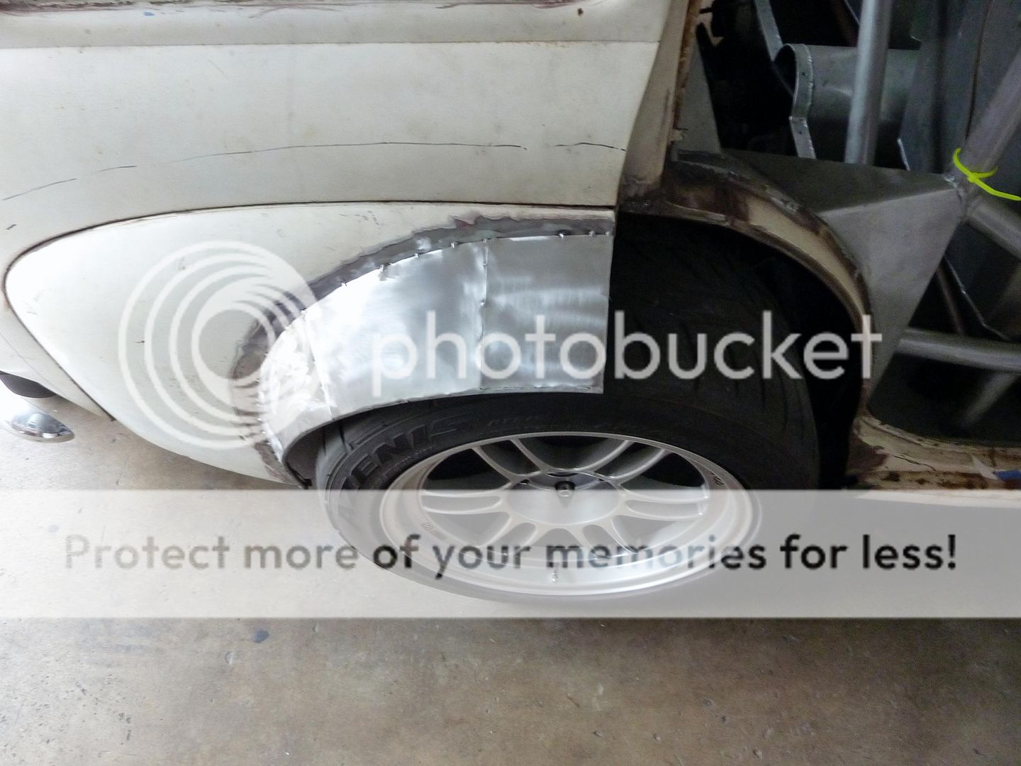

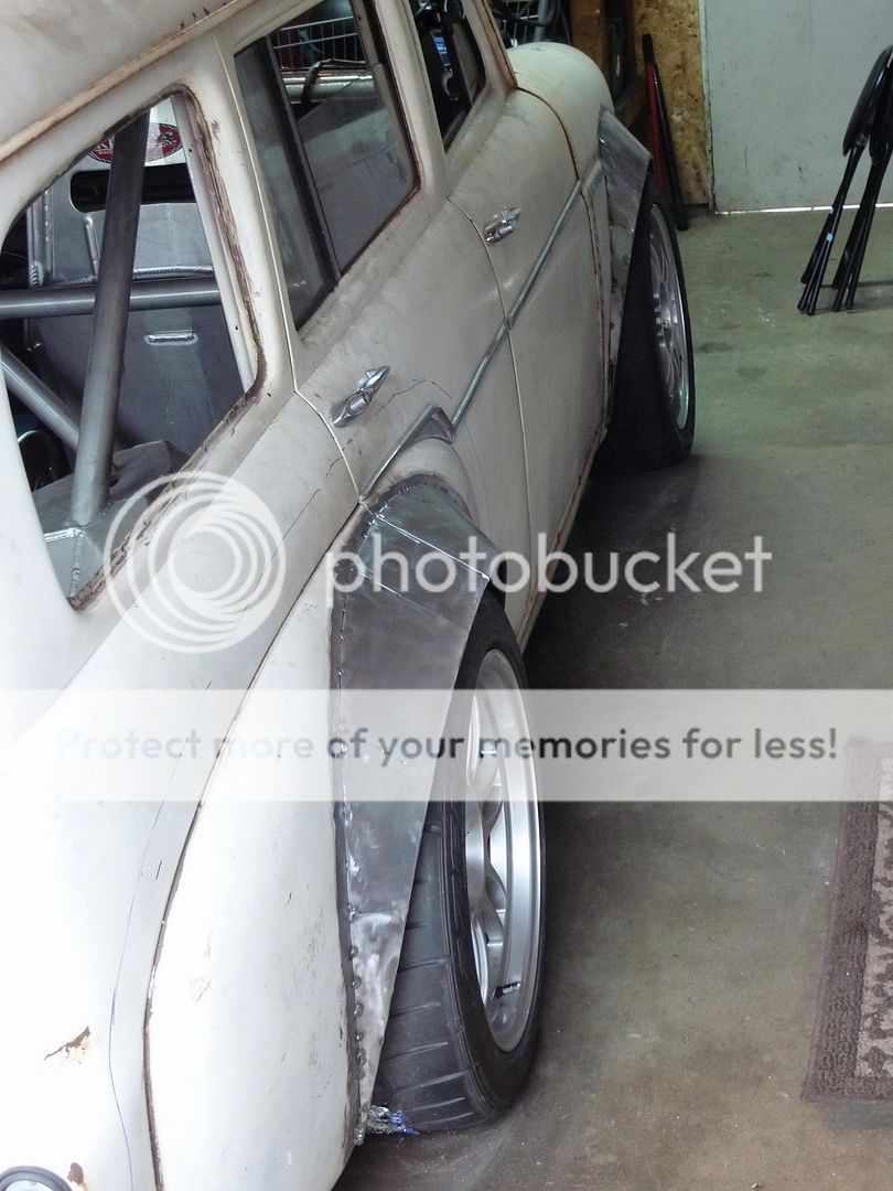

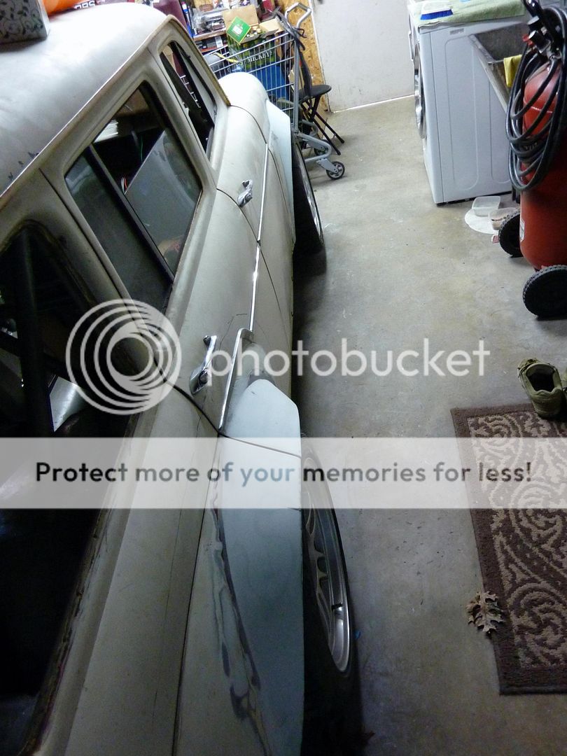

Wow, i haven't really updated this in a while. This project is still plugging along slowly.

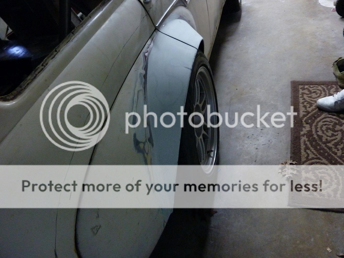

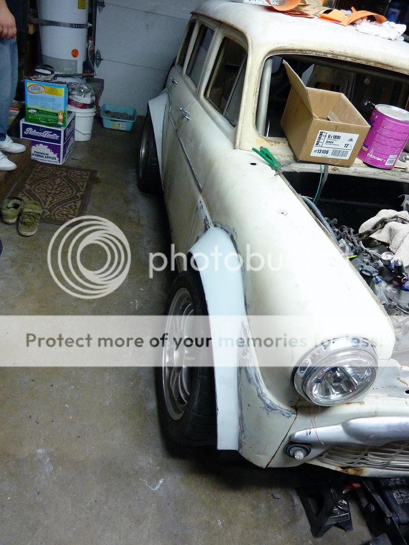

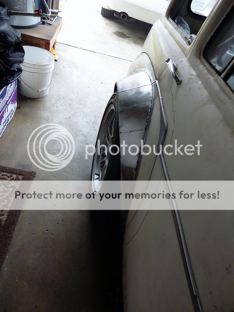

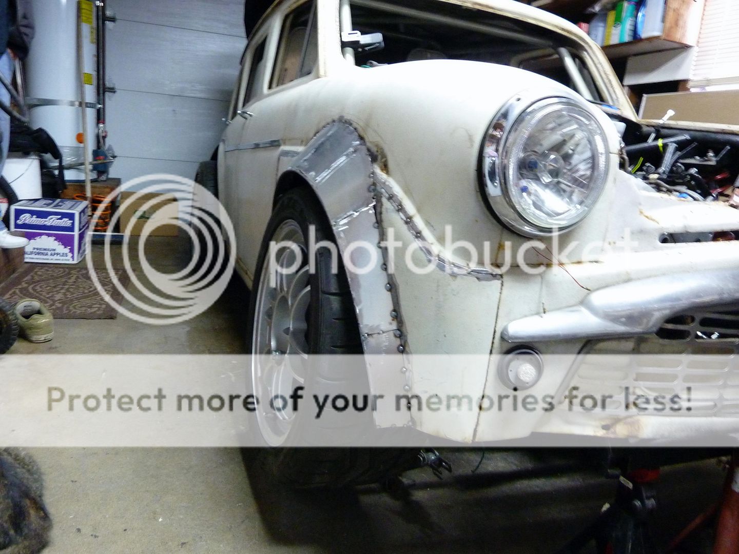

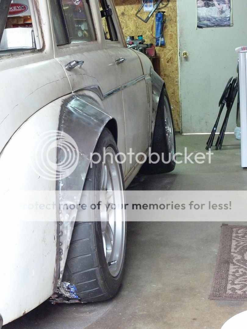

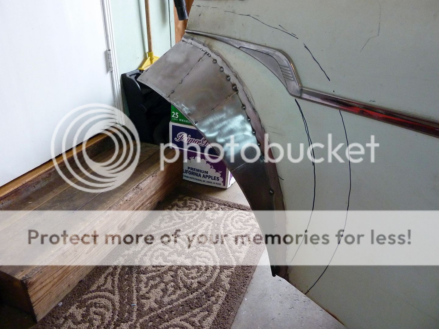

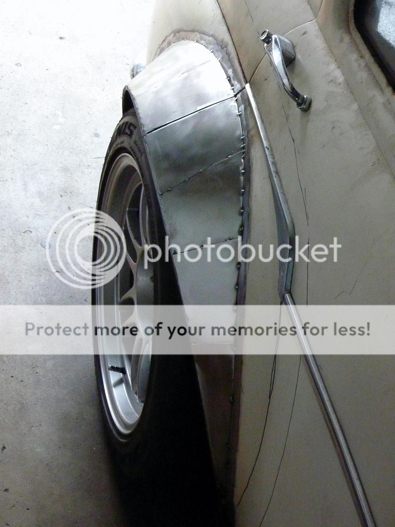

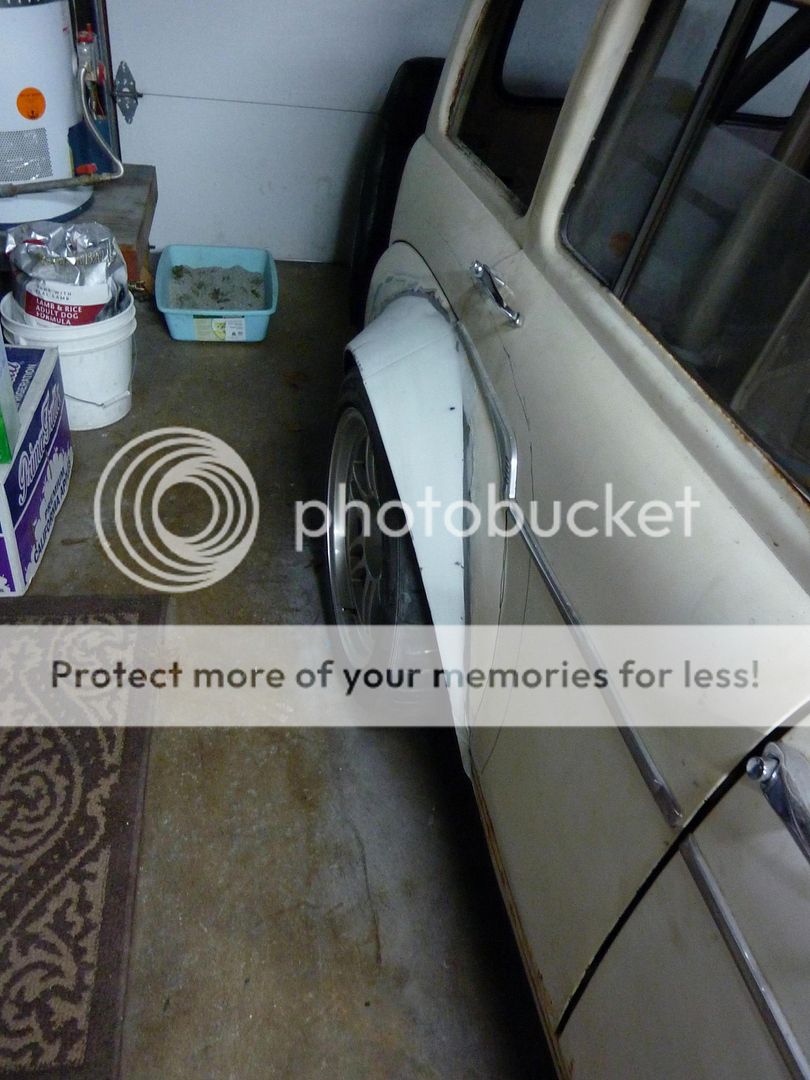

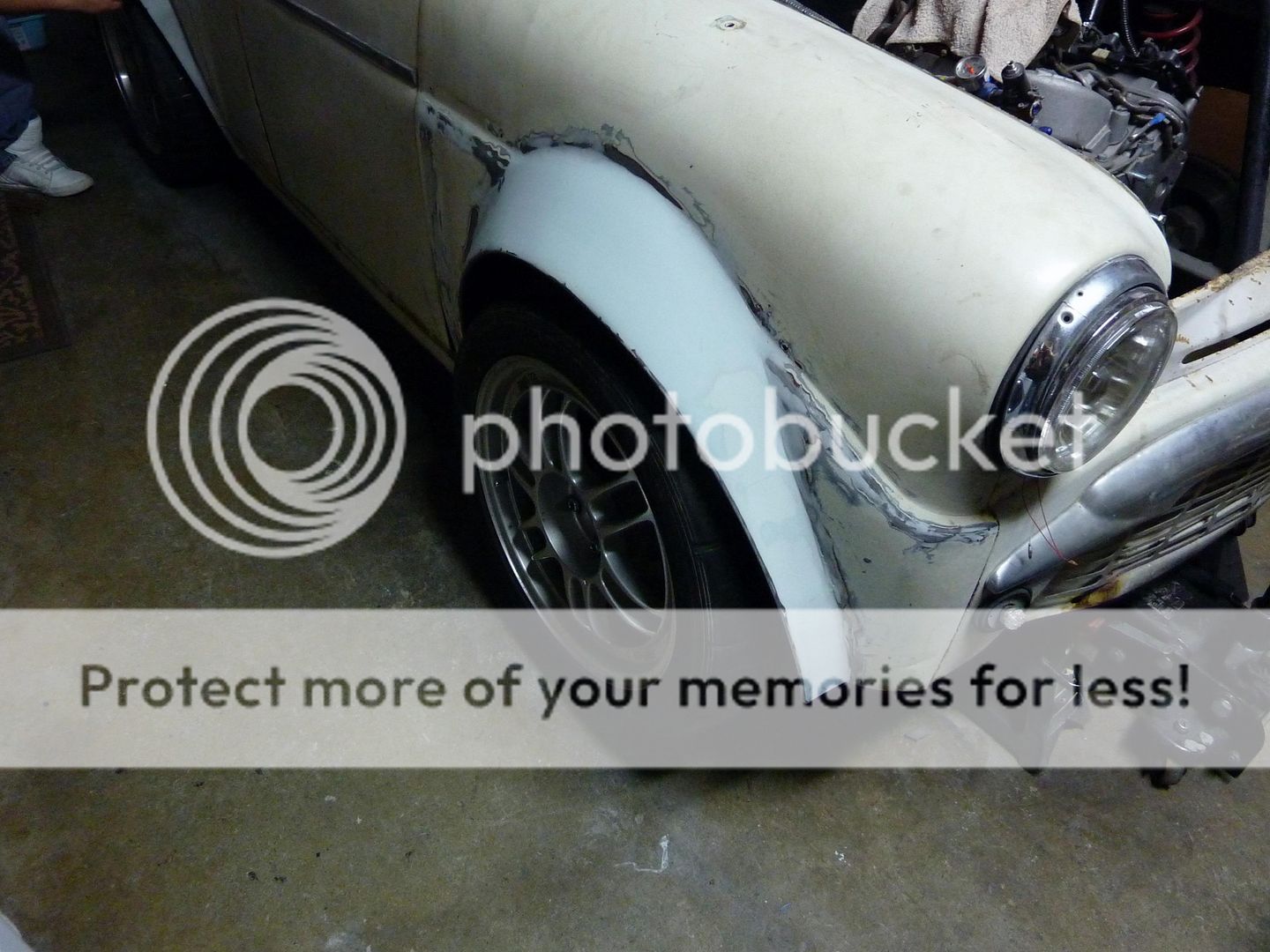

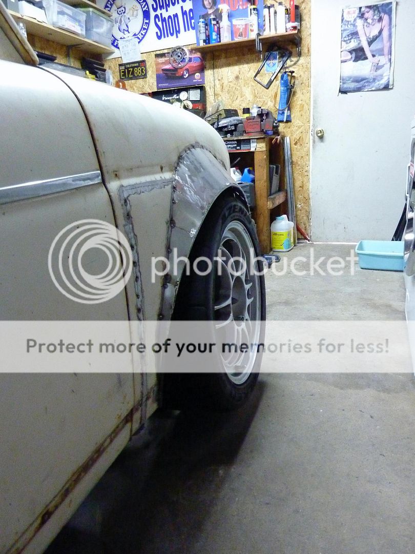

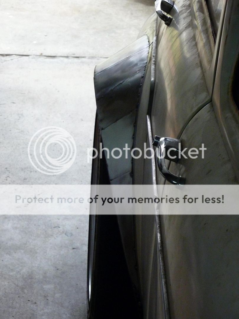

Right now, i'm having a buddy of mine do the flares.
I know that the angle on the front and rear flares are a bit different, i love them. Considering what the guy had to work with, they came out great.
Following that, we'll be fixing other peoples mistakes.

The flares are actually supported underneath with 1/4" round bar, along the outer perimeter of the flare, and every 6-8" from the outer lip to the body. I can kick them and they don't move :-)
And yeah, it's not a build a lot of people would do. It's far from perfect. I've got a ton of money into this thing, and i could do it for a bit more than half next time. But hey, it's a labor of love and i cant wait to drive it!
