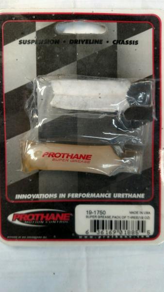

If you have poly bushings in the swaybar and didn't grease them, they can squeak like crazy. There is a specific, very thick grease used for that. grease.jpg
