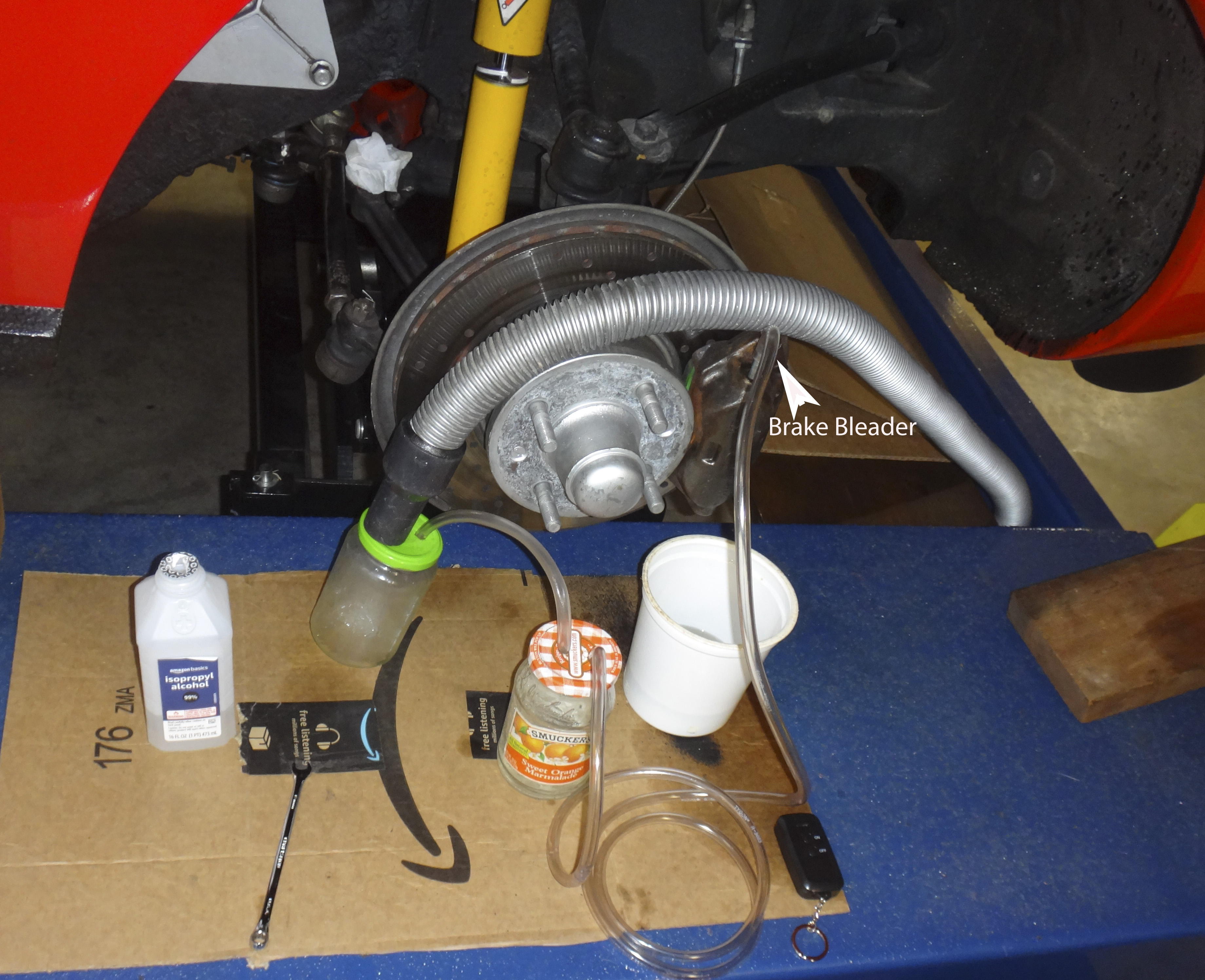

I use 99% isopropyl alcohol to flush Dot 3, Dot 4, or Dot 5.1 brake fluids from the system. These fluids are pretty soluble in iso, what doesn’t dissolve floats on the surface of the iso. By purging from the top of the calipers or clutch slave cylinder one can purge the glycol-based fluids quite effectively. And then one just continues to draw air through the system to evaporate the residual iso.
This photo shows my set-up, illustrated on our Montreal. The shop vac hose is over a hole in the green bottle cap. This creates a vacuum in the green bottle which is then transferred to the orange plaid bottle via the connecting hose. The orange plaid bottle is connected to the brake bleeder, which is opened a half turn.
The orange bottle collects most of the extracted paint remover, the plaid bottle keeps the paint remover out of the vacuum hose. Mostly.
Note the key-fob – if you don’t have a remote for your shop vac – you really need one.
To get started, crack open the brake bleeder on one of the calipers. Hook up the hose from the orange bottle, and urn on the vacuum. You will start pulling the old brake fluid out of the system. When the Dot 3 or 4 quits flowing I add 99% isopropyl alcohol to the brake reservoir and suck it through. Note, the iso is quite a bit less viscous so it will flow faster.
I do the above for every bleeder on all of the brake calipers until only clear isopropyl is coming out. A couple of flushes for each bleeder does the trick.

When I am getting no more iso in the jars, I next pull air through each bleeder until I get no more iso out of the caliper. Now it is time to purge with Dot 5. I recommend purging until it is obvious that only Dot 5 is coming out of each bleeder.

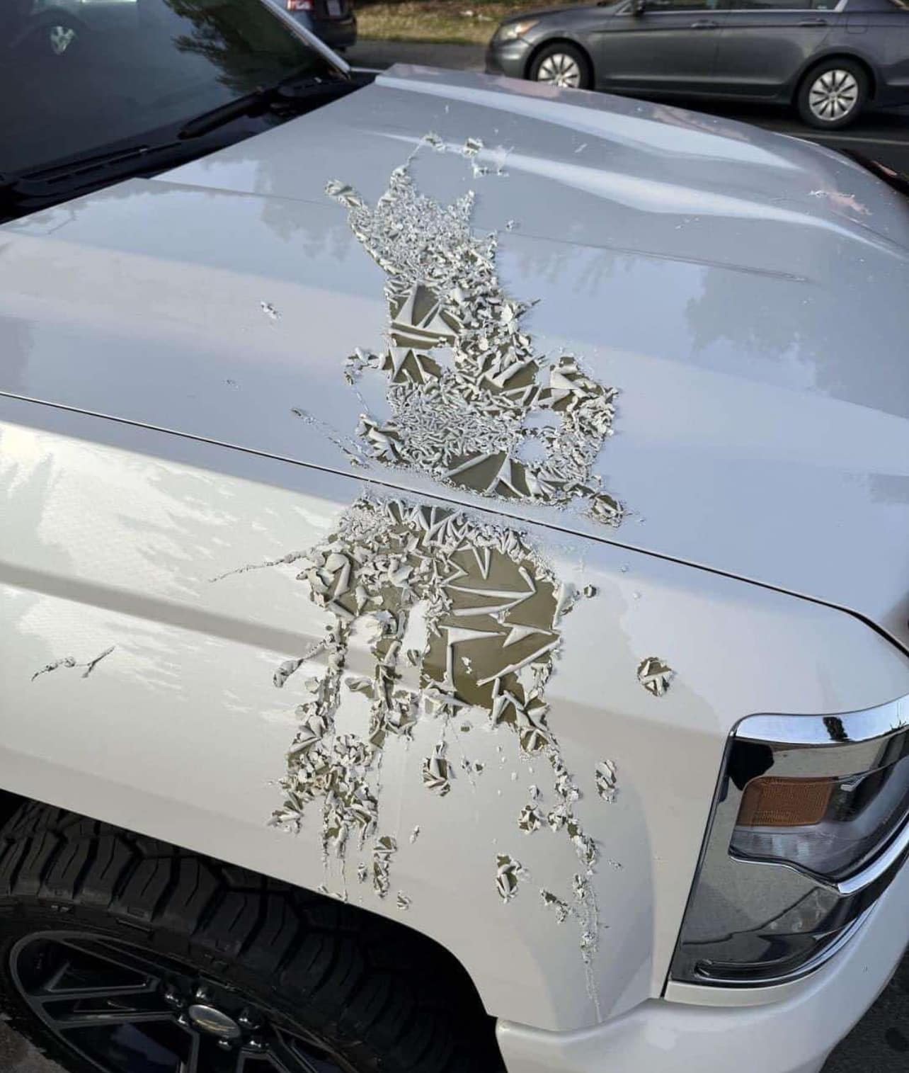

A great shot of what happens when the car on the lift leaks glycol-based brake fluid on the car parked under it:
