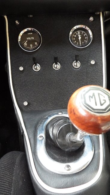

Got a period correct voltmeter and clock for the MGB here, from Nisonger. Along with an analog clock. Voltmeter is switched as Charlie said, clock is "hot" constantly. Great additions to the old lump!
