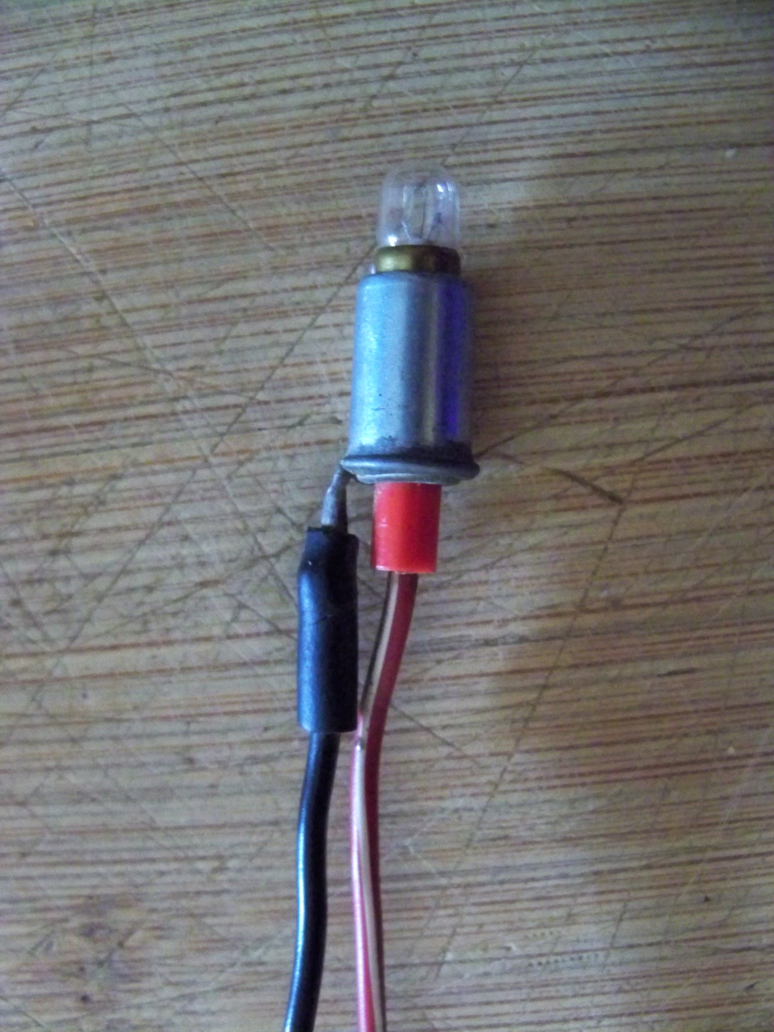

Thought about it but there is no way to repair it. The red sleeve inside that is on a spring is no good and there's just no way of opening it. Unless you know how to do it?So why not just repair the receptacle that you have?
smilie in place of the real @
Why can you just solder a new wire lead onto the base where it broke off without opening the receptacle?Thought about it but there is no way to repair it. The red sleeve inside that is on a spring is no good and there's just no way of opening it. Unless you know how to do it?
You have to see it to understand it. Believe me I looked at it for a long time trying to figure out if I could somehow save it but can't.Why can you just solder a new wire lead onto the base where it broke off without opening the receptacle?
If that’s not possible then carefully drill it out and use a rivet with a hollow tube to solder a new wire in. I’m sure you can cut some plastic material for insulation and find a suitable spring or just reuse the old spring.
Nope. Another dead end but thanks. I thought for sure someone would have an old one laying around somewhere.You might try Holden also. I find they have all kids of stuff that I don't need, but love to look through.

Thanks very much but I found them this morning..Check and see if the bulb socket that goes into the 'Wiper" lamp or the "Hazard Warning" lamp on your dash will fit into your voltmeter; if so, I have one of those I can spare to put in your voltmeter...BUT it is a bayonet, which means you'd have to buy and use a LED bayonet bulb.
OR you could buy the Moss bulb holder that I linked and just end it all with getting the bayonet LED
BA7s LED Bulb - 1 LED - BA7s Base
LED replacement bulbs can fit numerous vehicle applications such as dashboard lights, instrument cluster lights and gauge lights. The single-contact BA7s LED bulb replaces traditional 3898 and 16037 bulbs. It has 1 LED that emits a wide 100° viewing angle. European midget bayonet base for easy...www.superbrightleds.com
