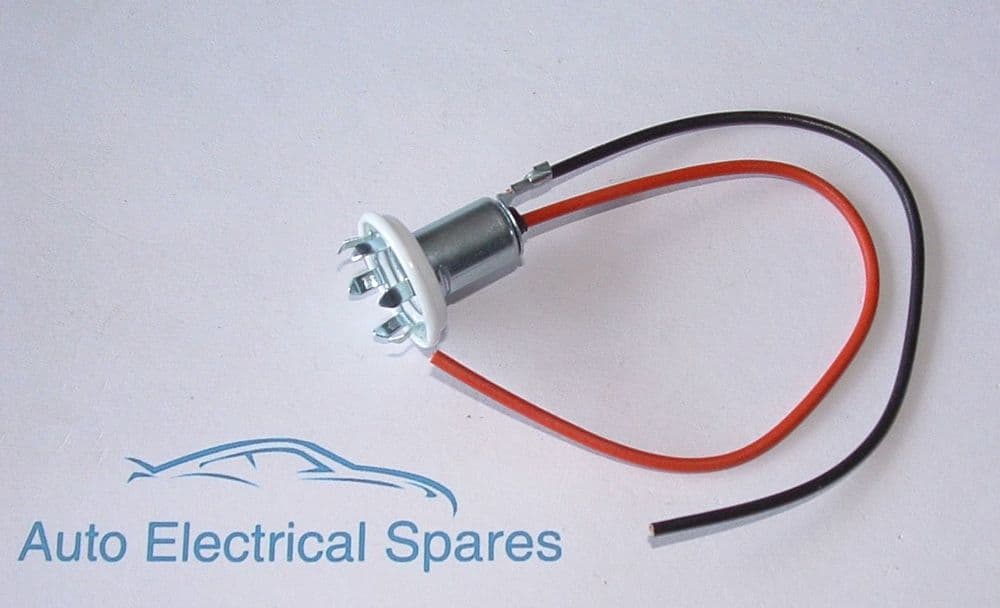

And if not Rimmers (or TRF) this may work and you may not need to use the black ground wire on this holder if the bulb holder grounds on the case.

It's the one in the link I posted..It says for Smiths Speedo,. Check the hole opening in the specs and see how it compares with the one for the Lucas voltmeter ...

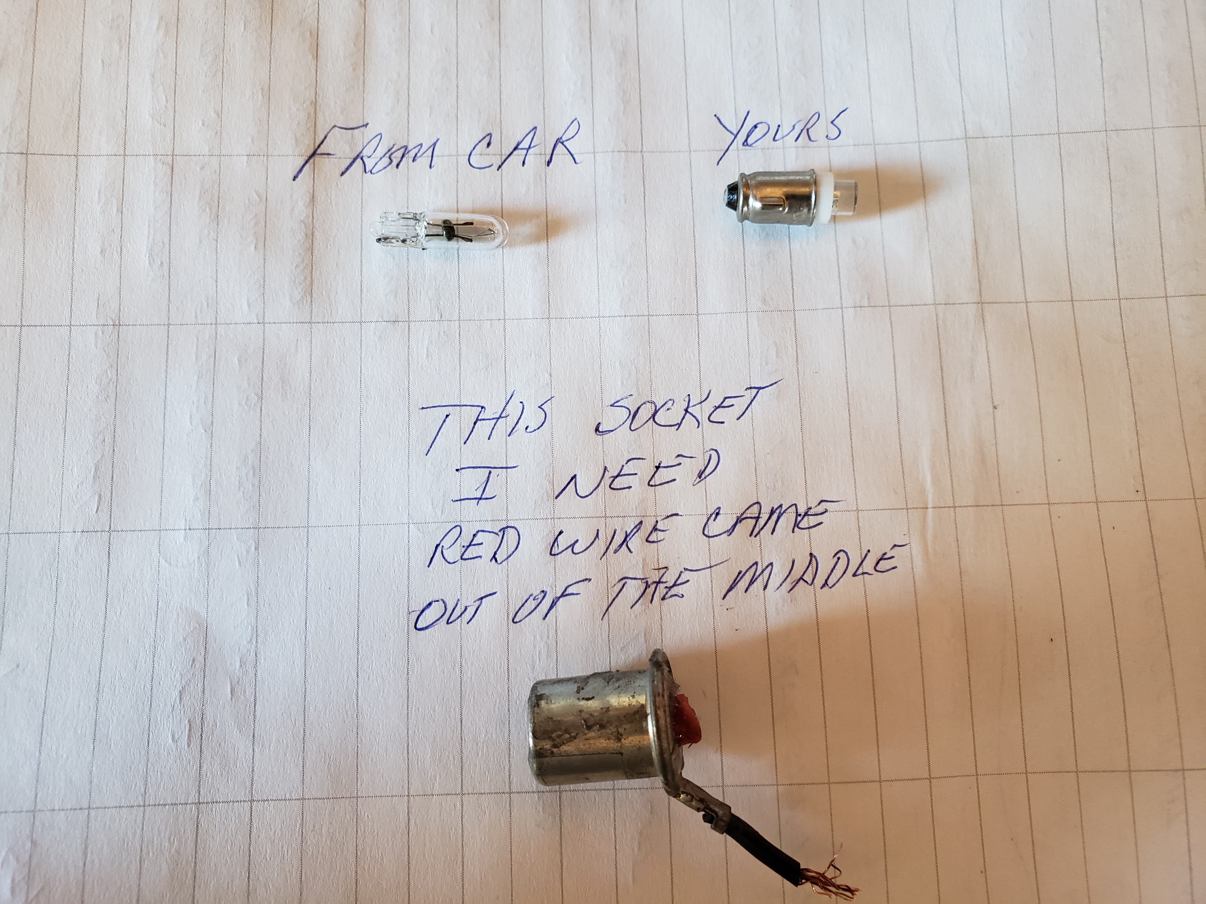

Thanks but that is the style that goes in the speedo and tach. I need the one without the little claws that goes into the small gauges. Can't find it anywhere. Here's a pic - the bulbs were sent by an LED guy. The receptacle is the one I need...

It should be an easy fix to solder a new wire onto the center post of the original receptacle.
I saw that and called MOSS tech support and they said it will not work for screw in bulbs.
The picture you posted shows an LED bulb with a bayonet base. not the Edison (aka screw) base.
The bulb holder from Moss is also for a bayonet base bulb is it not ?
No, no, the 2 bulbs in the picture are NOT for the instruments, they are for the plinth, except the large one was sent by mistake. That is a picture I sent to the LED guy to see if HE had a socket. All of my LED's, like the original bulbs are screw types. Believe me I have talked to MOSS, coventry, Rimmers, SNG Barrett, Northwest, and several others in search of this socket. It MUST be out there somewhere.
So why not just repair the receptacle that you have?
