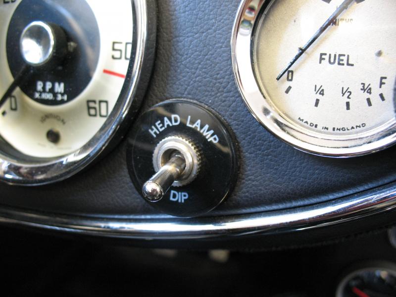

When I moved my OD switch to the shift knob, I put the headlight dip switch in its place and made a dead pedal for my left foot when not using the clutch.

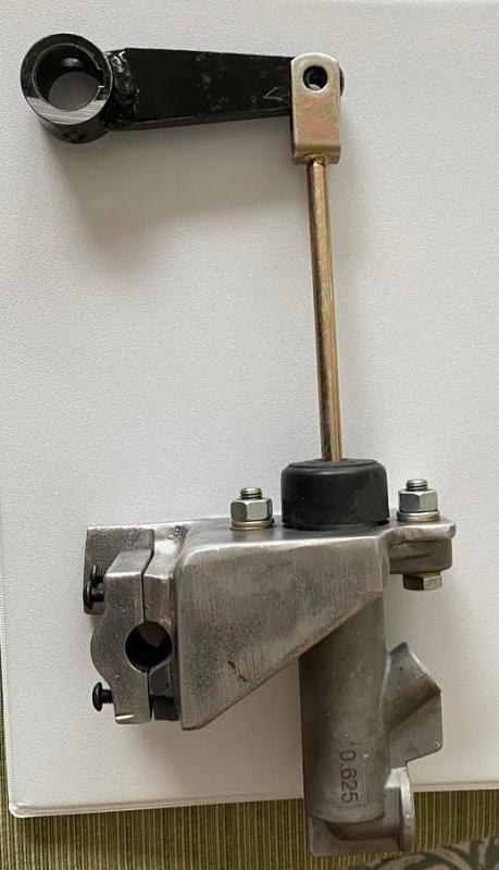

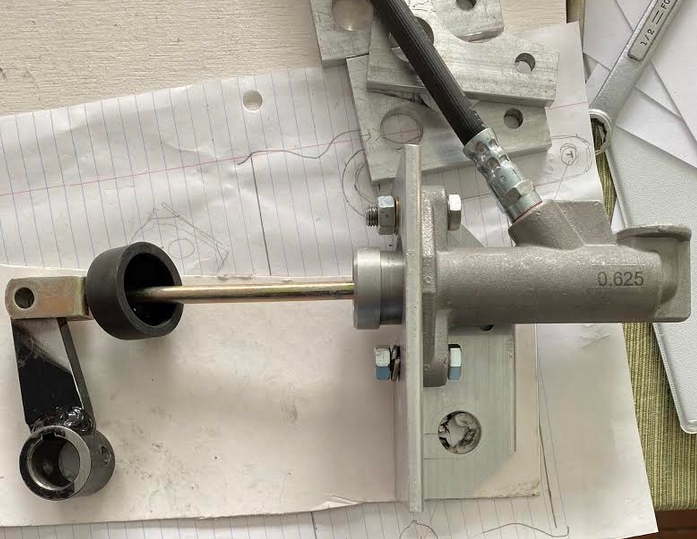

pictures courtesy Dave Deamer, who just installed the 5-speed on his BN1.
Stock bracket:
Dave's bracket under construction:
Steve, thanks for posting those. I'm sure it will make sense when I have the kit in front of me.
Though the present mis/malalignment of the clutch linkage in my car's setup has never given a moment's pause since first installation I will certainly opt for Deamer's upgrade if for no other reason than it looks so nice.

John, I did the same thing ... pic enclosed.... Jags had a nice addition for that.
