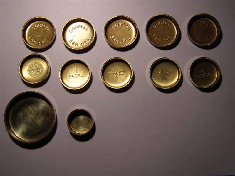

Here's a picture of what I took to the shop after the exchange:
