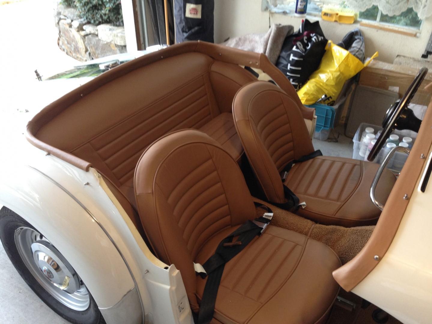

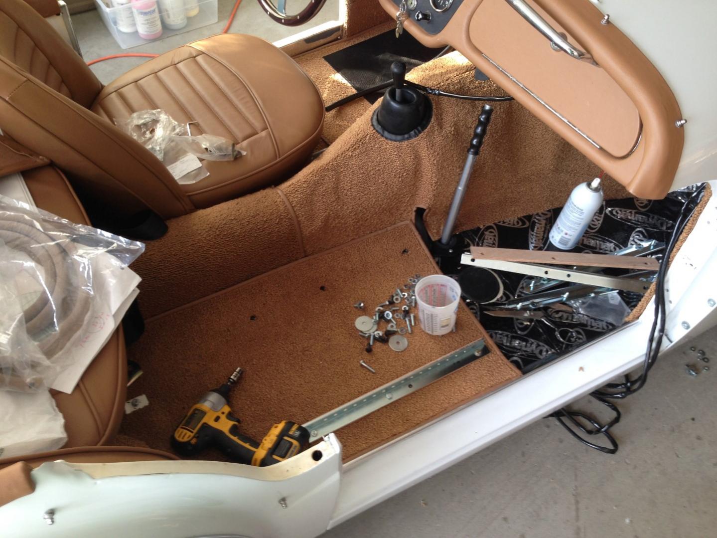

So, I'm installing carpet on Gwyneth (My British Mistress, aptly named by my better half), and have learned a couple things.

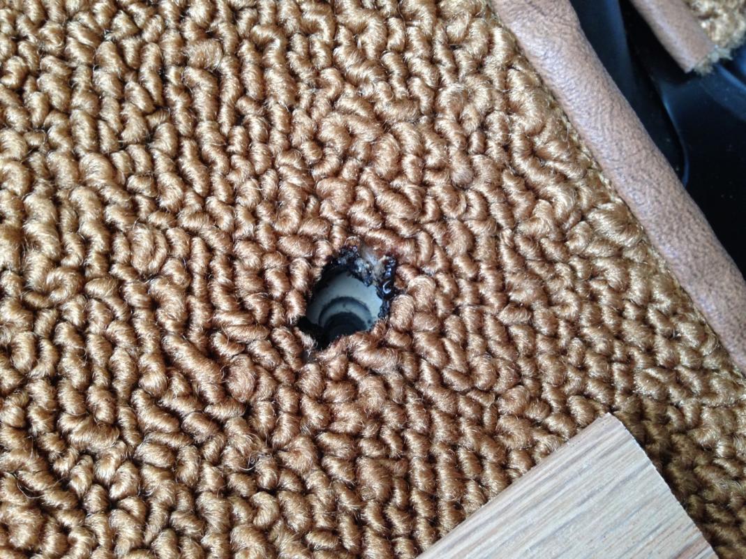

First, easiest way to locate and make holes in carpet for seat tracks is by running an awl through the captive nut beneath the floor boards and then chasing the awl with a hot soldering iron. If you try and drill the carpet, you will snag and your intended little hole will be very large before you can react.... So, burning the hole worked well. The hole is covered by seat track anyway.

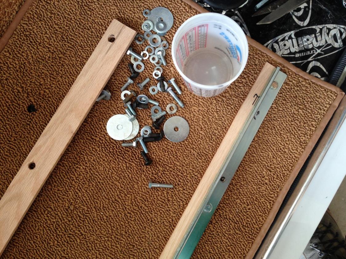

For seats purchased from Too Tall Tim of Ohio, I needed to add a small spacer (quarter inch) to raise the seat track. Otherwise, the seat dragged on the floor and just could not be easily slid fore and aft. So, I grabbed some oak trim from Home Despot and cut to size. Worked well and doesn't look too bad.
Third, the seat tracks from TRF were a little problematic. The seat slide with the lever (to adjust seat fore and aft) required some tweaking. The slide lever fouled the seat base before the lever was actuated adequately to unlock the seat slide. So, I had to heat up the lever with my oxy/acetylene torch and bend the lever outwards to allow the required full travel of the lever, without fouling the base.
Use a little lube on the seat slides (I used white lithium spray grease).
With that, I'm pretty happy with the installation.
Hope this helps the next guy.

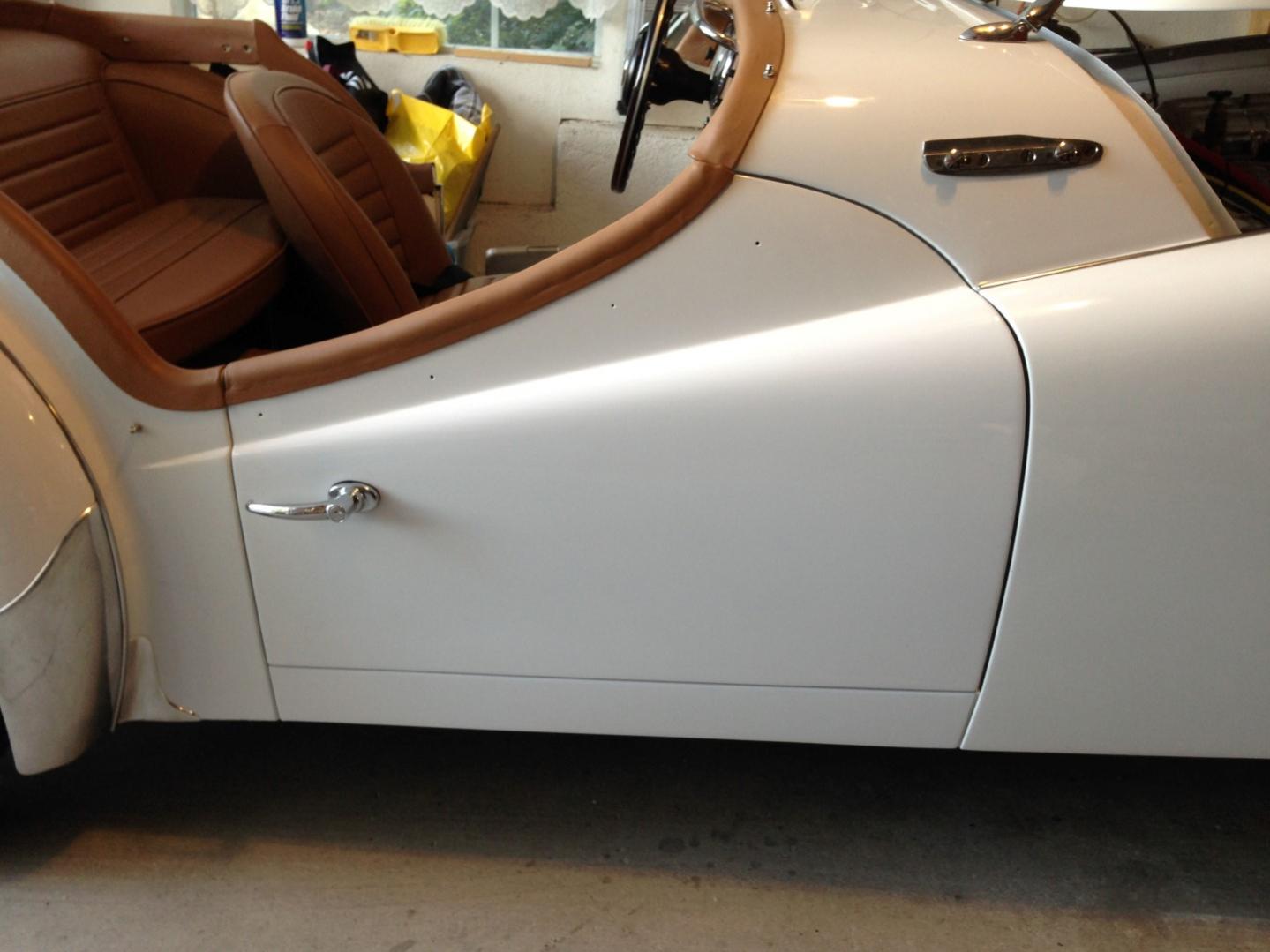

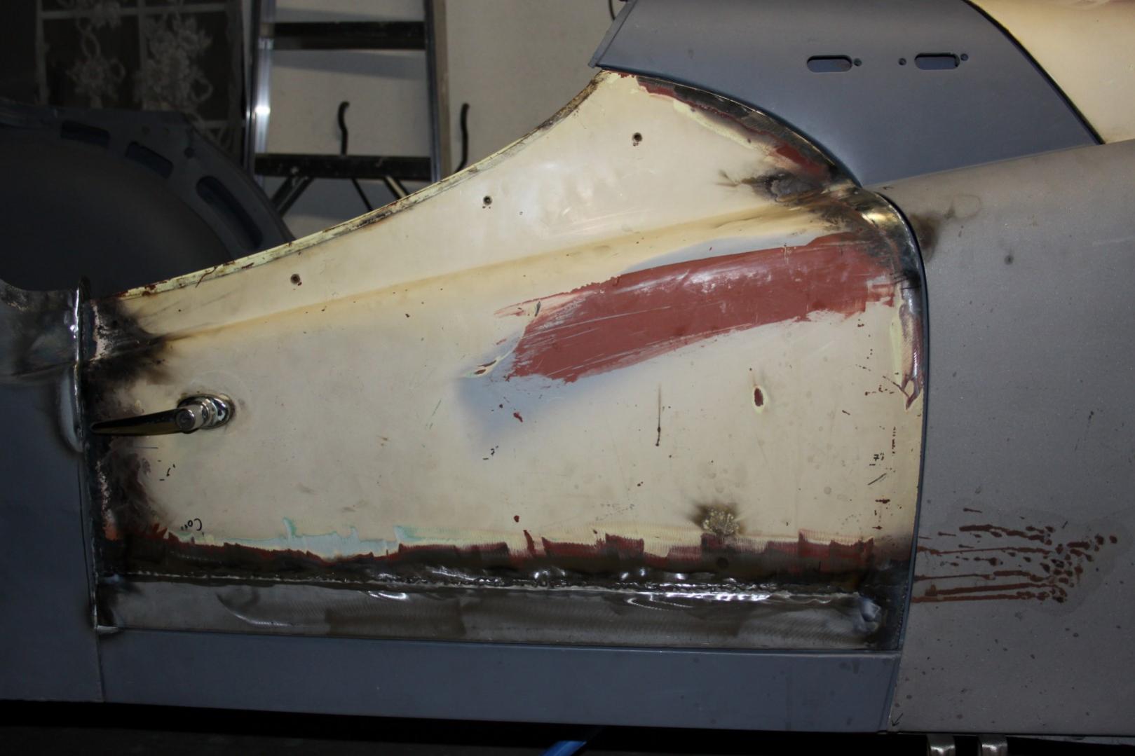

I also am having trouble fitting the door panels. With panels in place, I cannot close doors. The lower hardboard/leather inner door panel is too thick to allow the door to close on the upper lip of the sill. I may have to cut a quarter inch off the bottom of the door panel to allow the fit. Anyone else have this problem?

All my interior came from Too Tall Tim also. All fit very well. Is it possible that you are a little to low?

Hey Dan
Do your door panels fit in between door bottom edge and sill lip? Or does door panel ride above the sill lip? It could be a door fitment issue. My doors are super tight. I had to do quite a bit of rebuilding of the door bottoms (skin and friend) and may have made them a bit fat. If I raise the door panel up a bit, it just interferes with the curved part of the door opening (but that position does look good up against the door top capping). Thanks
