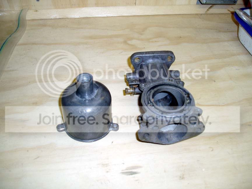

I'm rebuilding the H6 SUs carburetors for my TR3. In the past I would have been pleased with the progress but after looking at all the shiny carbs at the shows, these look a bit shabby. In particular, the alloy housings have become stained and dark. here what I tried: Two day soak in "Gunk " carburetor cleaner, hot soak and brush scrub in simple Green, white vinegar soak, "Mothers" aluminum polish and finally a buffing with abrasive. Still blotchy and dark. I know sodablasting will probably work but I'm looking for a DIY solution. Thanks in advance. Tom
Sweet. I'll post a pic in a day or two. Tom

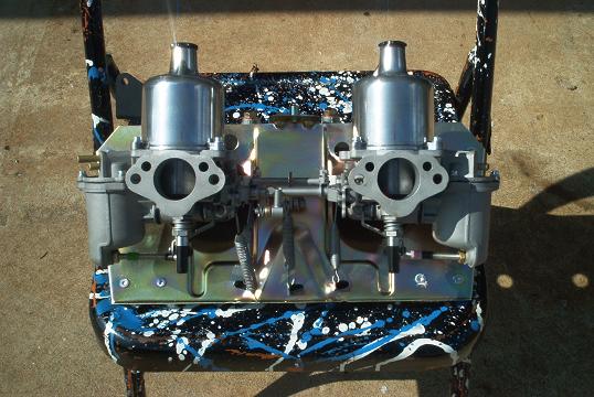

Looks like those carbs have been put in some sort of water based degreaser, you have to be careful when using most water based chemicals like Purple Power, Simple Green, Orange solvent cleaners, that all have the same checmical in them that will discolor aluminum, leaving it with a darker greyish stain on them, if thats the case, media cleaning is al that will remove that checmical staining. I would recommend for home DIYer, getting a bucket of Berryhil carburator cleaner, and letting the disassembled carb parts soak in that. As for the dashpots I would polish them with a white rouge on a buffing wheel. Here's a set of my carbs, after degreasing, I use fine glass at low air pressure for the carbs bodies, float bowls and float bowl lid, then plastic media on the dashpots, and pistons. I clean the pistons by mounting them in a drill press chuck and using 3M 7447 scotchbrite, and then also use the 7447 for cleaning the inside of the dashpots.

I guess I do / did mine the Olde Fashioned Way. A 3/4HP Baldor Buffer with a "Floppy" buffing wheel. 2 Rouges; One to "Rough" & I use a "White" (Jewelers Compound) to finish. I`ll try to post a pic here but I hate to shrink my pics down to nothing cause I can`t seem to get them back to size.
