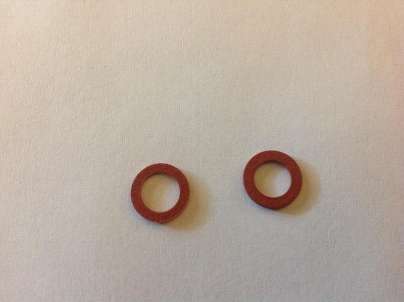

I was talking about the fiber washer that goes under the float valve, the little red ones. This moves the seat closer to the float arm. I do have 2 in my stash...new.
Rut
