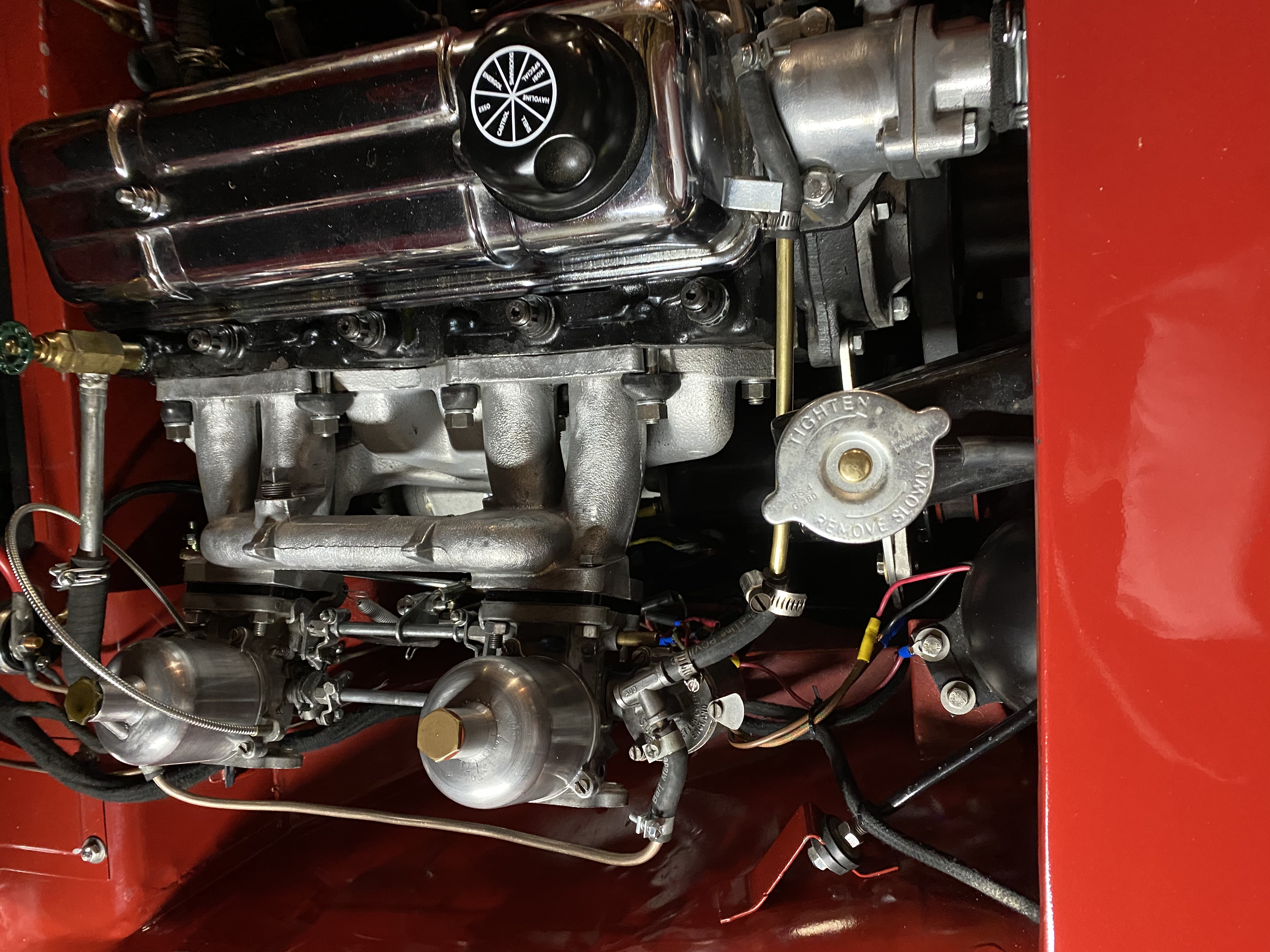

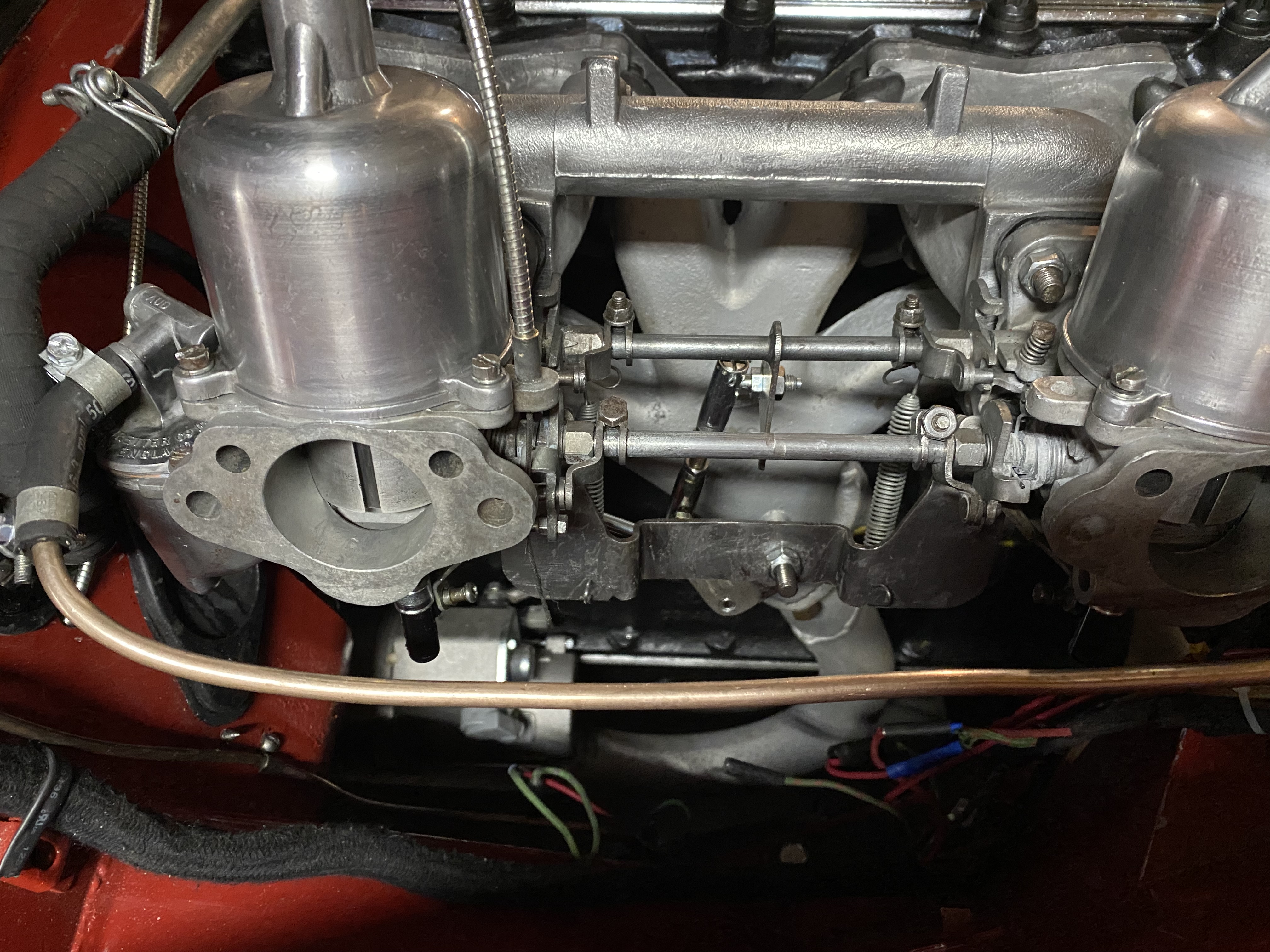

I want your advice. I will be rebuilding a TR3A engine with 87mm pistons. I have 3 choices for carburators:
1. Stock HS6
2. HD6
3. Webers DCOE 40s.
Question 1- Will the HD6s fit on the original intake manifold?
Question2- Is there anywhere to get just a manifold for the Webers?
Is there any advantage to any of these? While I am not restoring the car to strictly original, and I am not going to race the car, I would not mind seeing another 10-20 hp.
Jerry
1960 TR3A
