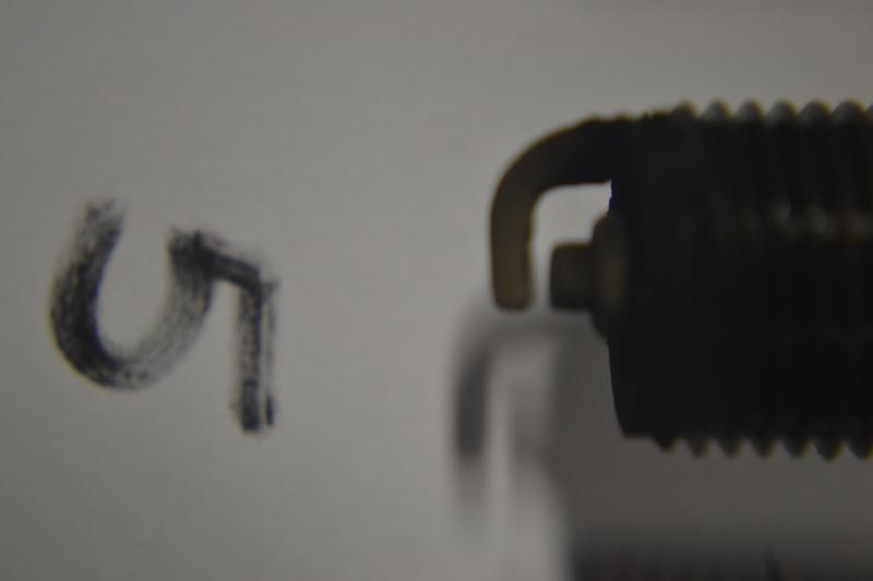

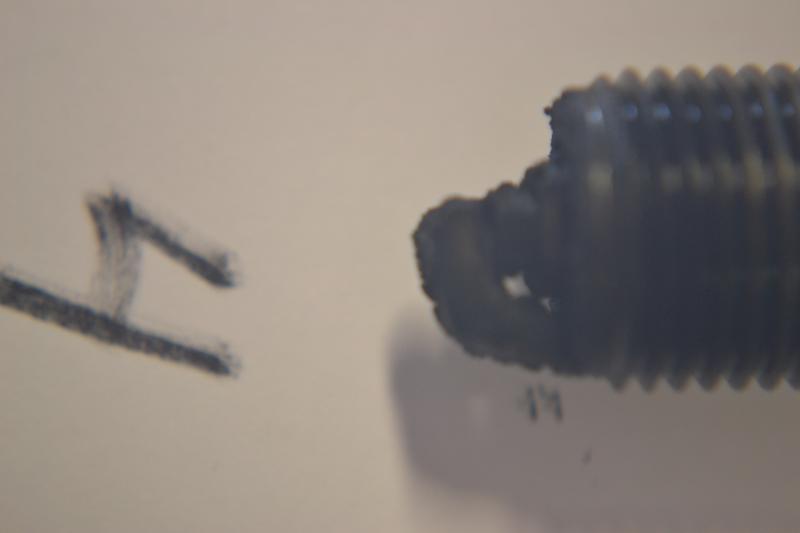

I have a 72 TR6. Last March I had the cylinder head rebuilt and the car ran great. Today I drove the car on a two hour round-trip. On the return home, the car began to miss ever so slightly at lower rpm. Tonight I pulled all six spark plugs. Most of them are in normal condition. Only #4 is carbon fouled and has bridged the gap almost completely. Everything I have researched has touched on the subject of an over-rich carburetor. The problem with this theory is the aft carb feeds plugs 4,5,and 6.
If this aft Stromberg carb is running too rich to foul #4 why did 5 and 6 survive? I am wondering if I should suspect a bad valve guide or valve itself? I will pull the valve cover off in the morning and check the adjustment and see if the valve is working. Beyond that, I am at a loss for explaining the carbon on this one plug. I am using the recommended Champion plugs and the timing is set properly. Has anyone else had this experience?

I am wondering if a compression check might be in order here.
poolboy
All 3 indicate a rich mixture. #4 just caught the worst of it.
TR4nut
I'm with Poolboy - if the other 2 cylinders looked better I'd be more worried about #4. For now I'd look at tuning your carbs including the front bank if they look the same. There is a slightly higher temp champion plug out there that people use which might help too.
Got_All_4
Looks over rich to me too. I'd clean them off, lean out the back carb and drive it a while and recheck after the same amount of miles since the head rebuild and reassess from there.
