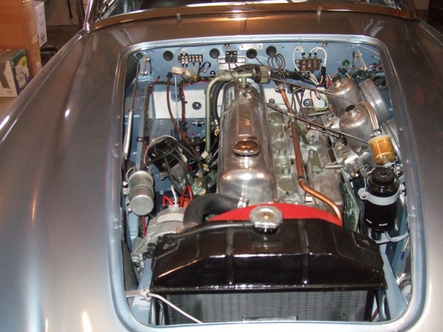

I've recently had the carbs off my BJ8 and fitted a complete rebuild kit including new spindles. I found before taking the carbs off that when I examined a plug it was always covered in soot now matter what I did to try and stop it. I've checked the timing and it's spot on.

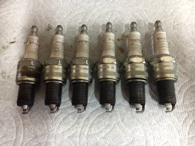

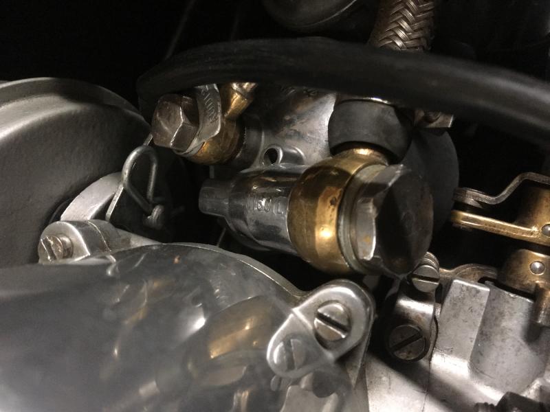

Anyway, I'm now trying to tune the new setup. I understand that BJ8's like to run a little rich and this is my experience from playing around before taking the carbs off. I have balanced the carbs with a sync gadget and I have a Colourtune plug. I've set the carbs with the Slow Running Valves fully closed like it says in my SU manual for multicarb cars. The setting is currently such that turning the mixture screw less than a 1/4 turn will change the Colourtune from yellow to blue. I have the car running so the Colourtune is on the yellow side and the car runs well. However I still have a layer of soot on the plugs. If I back the mixture off just a little it begins to show signs of running lean, it starts to falter when you depress the throttle as though it's running out of fuel. The soot is easily brushed off and the underlaying colour of the electrodes looks a chocolate brown as you'd expect. It seems to me that the soot is deposited during the idle process. I haven't yet done the test of stopping the car before it gets to idle as this is a little awkward where I live.
So, my question is whether I should ignore the SU Manual and try playing with the Slow Running Valve which seems to me will get more air into the engine during idle weakening the mixture at the idle point. Any thoughts would be appreciated.
