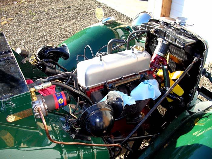

Hi Marty, my hat's off to you on the carb rebuild. I too have a 1952 TD that I bought last year, late summer. It has had similar problems with carbs and fuel system and oil seals. I pulled the engine and installed a Moss rear seal conversion kit & new front seal. I didn't feel confident enough to rebuild the carbs myself so I sent them to Lawrie Alexander at British Sports Car Center a week ago. Glad to hear things are going well. I am hoping for the same success with mine.
Rick
