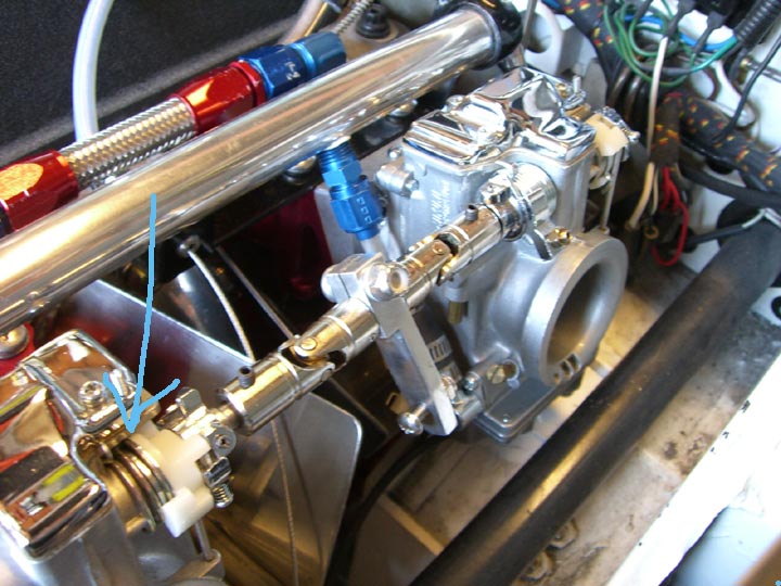

Sounds like a great idea. I always wished my HD8s had coaxial return springs instead of the straight springs that put the side load on the throttle shafts causing the carb body wear in the first place.
Well Bob, maybe you should come over to the dark side and install some Mikunis. Are these the springs you're talking about? :laugh:
