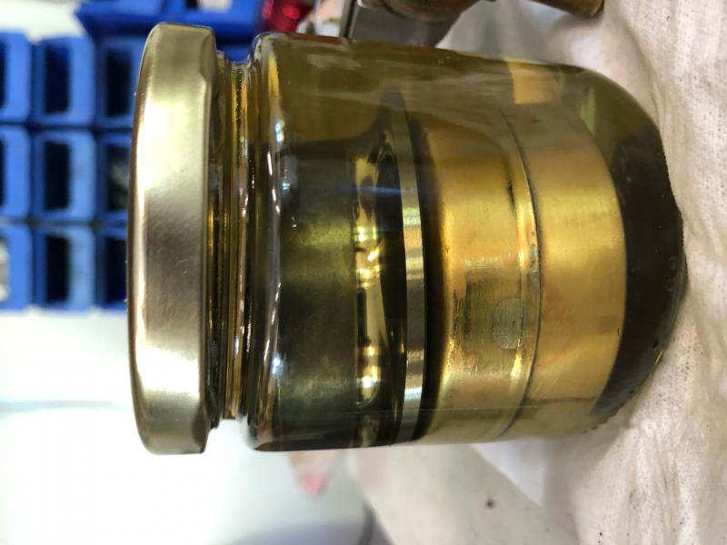

Ok so my trick worked , I warmed the float until I found the wet spot where the fuel was being forced out . I drilled a tiny hole in the wet spot to drain the fuel . I then soldered over the hole and filed off as much as possible to make the solder just a thin film .
I now have the float submerged in a sealed glass jar held down with an old bearing race .
Im going to give it a few days and see if the “submarine is taking on water”
my only concern now is if the tiny amount of added weight will affect the way the float moves up and down etc .

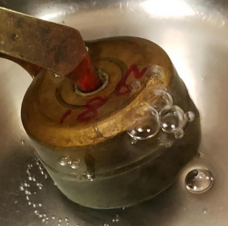

Hold it under the surface in a saucepan of boiling water and if there are any leaks you'll immediately see a stream of bubbles. Joe Curto suggests this and also states the brass floats are prone to stress cracking. A sunk float could be a single-point-of-failure out on the road.
Nitrophyl is a cellular hard rubber which is impervious to modern fuels. Holley, etc, are using it. I bought 2 from Moss to replace my brass floats and they weigh exactly the same in grams - a benefit, as the brass floats vary in weight, which gives different fuel volumes between the carbs.

In one of his videos, Joe Curto states the brass floats are prone to stress cracks.
I tested all 5 of my floats. Only this one leaked - at the solder joint.
