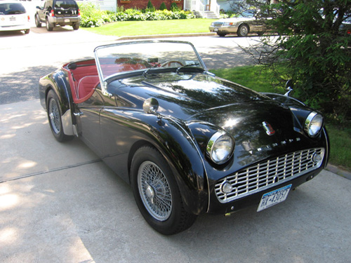

As far as painting panels at a time thats what I am doing and so far I see no difference in color, others might disagree. just stick to the same number of coats of base and the same number of clear coats. Metallics no way you better paint the whole car. solid colors mix your paint really well before reducing, I use a paint stirer that goes in a drill.

In the end I hope at least in my mind it will be worth it,
