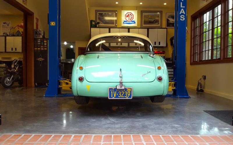

dougie
When I designed and built my new shop, I planned my "race bay" around a full lift two pillar system . It's one of the best things I did, I don't know how I ever lived without it. This system might work for you and it portable if you don't want to keep it up all the time.
https://www.amazon.com/Dannmar-MaxJ...020&sr=1-3&keywords=car+lifts+for+home+garage
