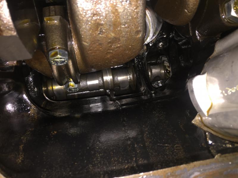

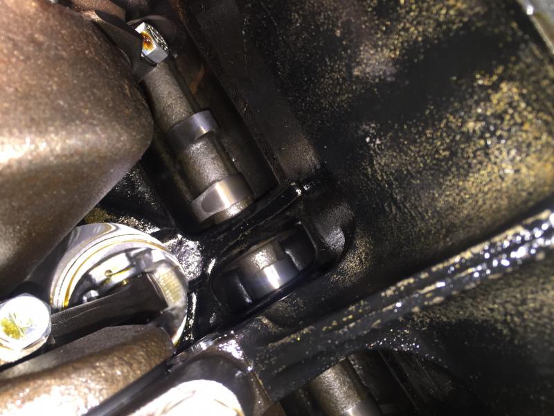

OK guys... I sent oil in for analysis, and dropped the pan tonight.
With a quick visual inspection I noticed wear and what looks like galling on the camshaft. See photos.
Notice there is a slight groove where the fuel pump arm rides on the cam, and the tops of most lobes look galled. This is a Goodparts GP2 camshaft I installed 6k miles ago, along with new tappets, rebuilt head, etc.
Any idea what's going on?

Wondering what oil you have been using for initial break in and afterwards.
Cheers
Tush
Two things come to mind, break in oil and procedure along with cam lube on install and hardness of the tappets. With that kind of wear I'm surprised you didn't see big changes in valve settings.
Rut
Sorry, this is not the news I'd hoped for. It's good you persisted with going inside and it would appear that the culprit is apparent although the information conveyed by a photograph is limited.
If you confirm the suspicions, it would appear that the cam/lifter issue has raised it's ugly head again, with questions of ZDDP oil, assembly lube, and hardness of both the cam and lifters.
I would begin by contacting Goodparts. I am sure they are aware of the issue.

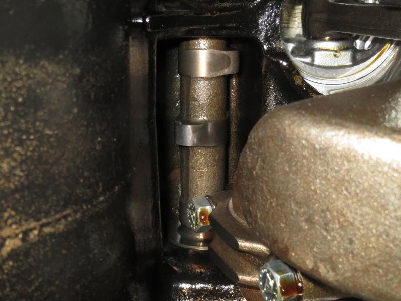

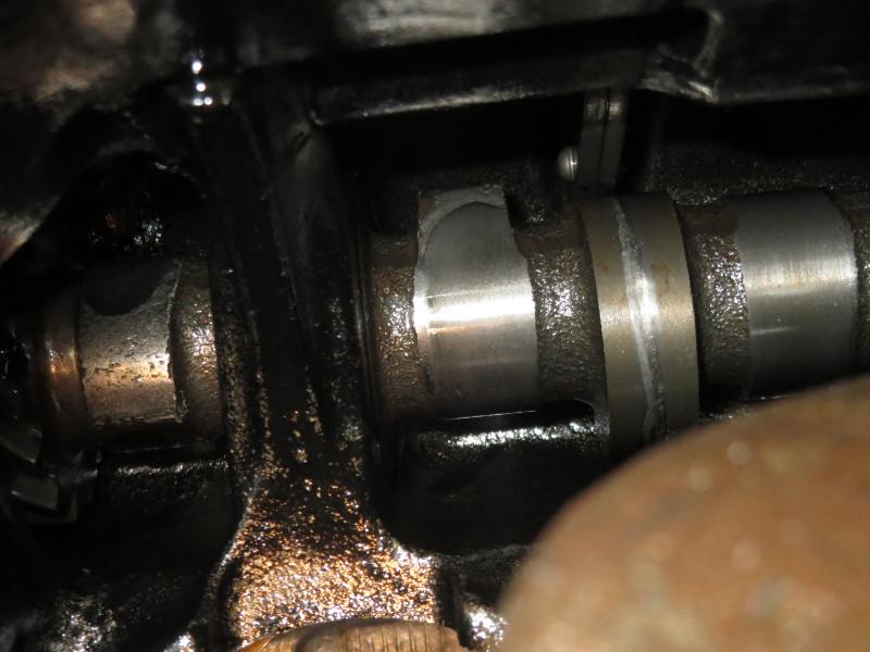

Here are a couple photos that show more detail...
attachment.php
attachment.php
- 6k miles since rebuild, used Castrol 10W-30 synthetic with four changes.
- Haven't checked valves since 1k miles.
- Did not use ZDDP.
- Was meticulous with cleanliness and assembly lube.
- Haven't taken the head off/tappets out yet.
The fact that the fuel pump is causing scoring make me think it's either a lubrication issue or cam issue? The pressure the fuel pump puts on the cam is so low compared to tappets?

While I'm sure the 2000 rpm run in and addition of ZDDP will mitigate these cam/lifter problems, the cynical side of me would say that there is more to it, namely poorly engineered and or poorly produced cams and or lifters. The fuel pump lobe would seem to support that cynicism. There is very little load on that lobe.
Other than oil chemistry, I think you can rule out lubrication problems. Most of the oil that lubricates the lobes comes from sump splash and there is not much that can go wrong there. Weep holes in the lifters my add something but they were never needed on the original engines. My 55 year old cam is back in the engine untouched and still good.
I would like to see some hardness data on these failed cams. Also wonder if the manufacturer includes run in and oil recommendations.
Tom
Tom--really appreciate that thread. Had not seen it.
I've done some research, talked to Richard, talked to a british car mechanic, a very knowledgeable friend, and unfortunately haven't come up with much. So I'm going to assume it was a bad cam, add the external oil feed line kit, and just try again.
Do any of you have recommendations for a mild street cam? I was happy with the GP2, but just wondering if there's anything with a similarly good reputation out there?
Did the right number of shims go under the distributor pedestal, if not the housing rubs on the distributor drive gear and loads of cast iron is passed around the oil galleries
The "shaving" looks like it could come from the thrust washers .
