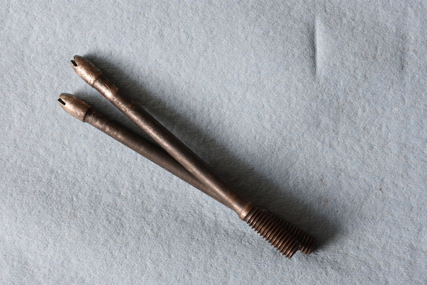

These are old head bolts from a twin-cam, Threaded heads machined to a cone with slots for screwdriver removal after use. They're to hold head gasket in position and aid in positioning head onto the block.
