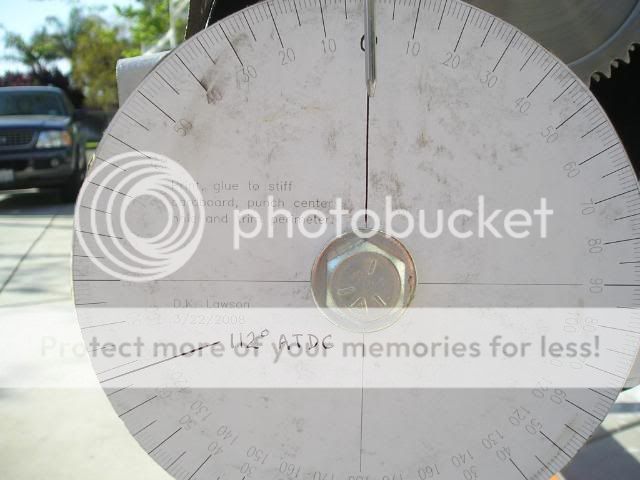

Check out this photo of a cam degree wheel. Calls a question.
This is differet than the protractor-type I used to
degree my cam.
Therfore a quadruple-check. Does the following marking
on this protractor indicate 112 degrees ATDC (After top dead
Center). I have heard some conflicting opinions on what is
before top dead center and what is after. One more time.
Note my line drawn darker at what I think to be 112 after top
dead center. Thanks.
