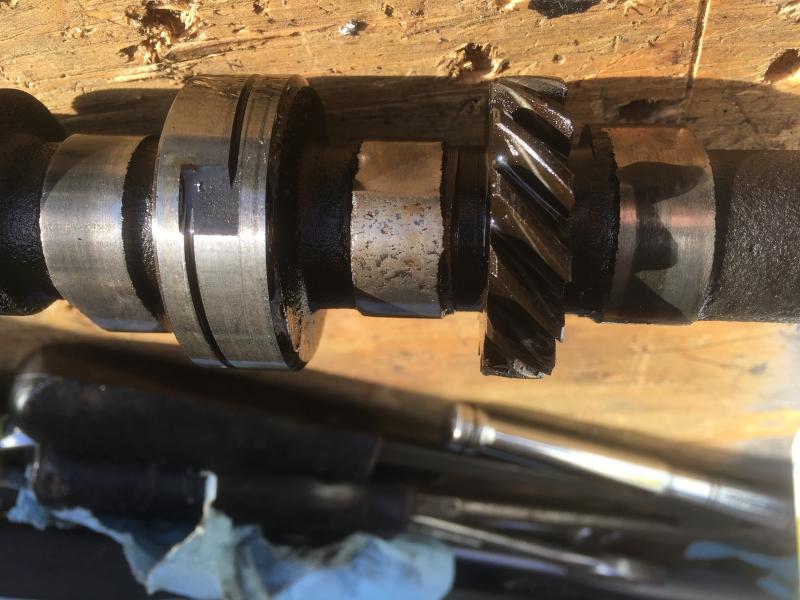

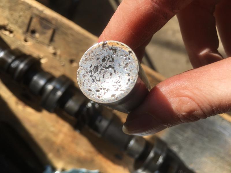

Pursuant to the my thread about the broken bearing cap while I was disassembling the engine to take it for a line bore, I noticed the following:
The question now is not if I should replace the cam but which one to get. It seems there is a lot of choice out there and they are all a little bit different.
So, I'd appreciate some recommendations as to which cam to get.
My use of the car will be as a daily driver, with about 75% city driving. One of the features of the TR6 that I like is the low end torque that the motor has, and that is one thing I'd like to retain. However if I'm paying for a new cam I'd like to up the power a bit (while retaining the torque), but not too much as I still want decent fuel economy. Also I am going to fuel inject it as well.

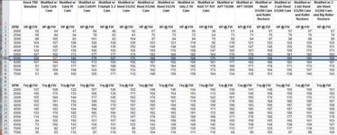

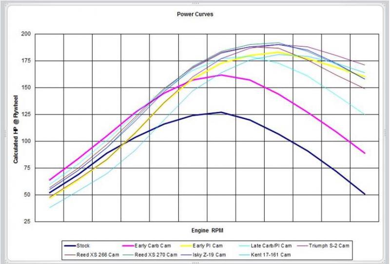

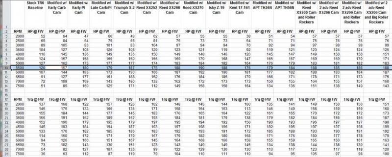

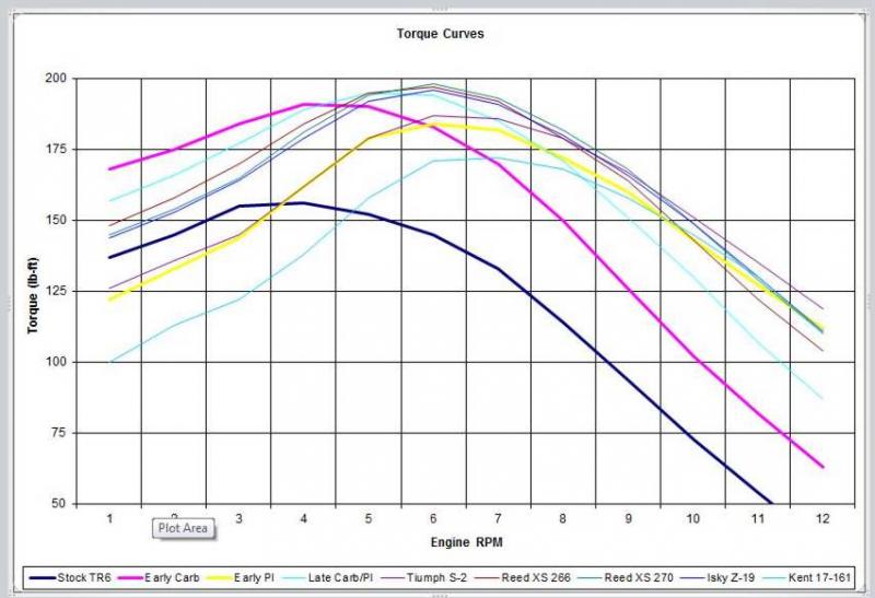

I had thought about suggesting that one but since I seemed to recall that the OP had a '76 TR6, that's the cam he already has. If he had an early TR6 it would have definitely have gotten a good mention. We had been using Desktop Dyno for building engine models for a GT4 Nissan we were racing at the time and that is what I used for the modeling my TR6 engine with various cams. The downside of Desktop Dyno is that we always thought that it was overly optimistic about the calculated power and torque but we did find that the trends shown in the models held up. So having said that, take the numbers in the attached spreadsheet with a grain of salt but pay attention to the trends. Note that the "stock" TR6 is an early carb model with the mildest of cams fitted to these cars, there is a plot for that cam with the higher compression ratio, head work and triple Webers as well.
