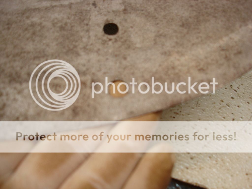

TS1- TS6500 had four slits in the raised portion and should have two rivets near the back edge. Rivets ended around TS22530. I can't find when the sheered edge ended, most likely when they discontinued the two rivets.

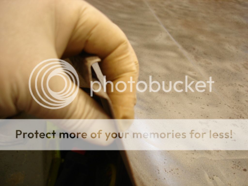

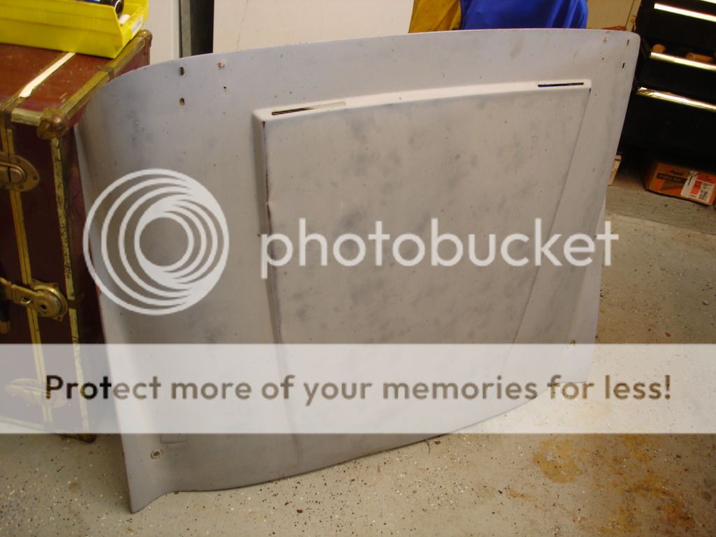

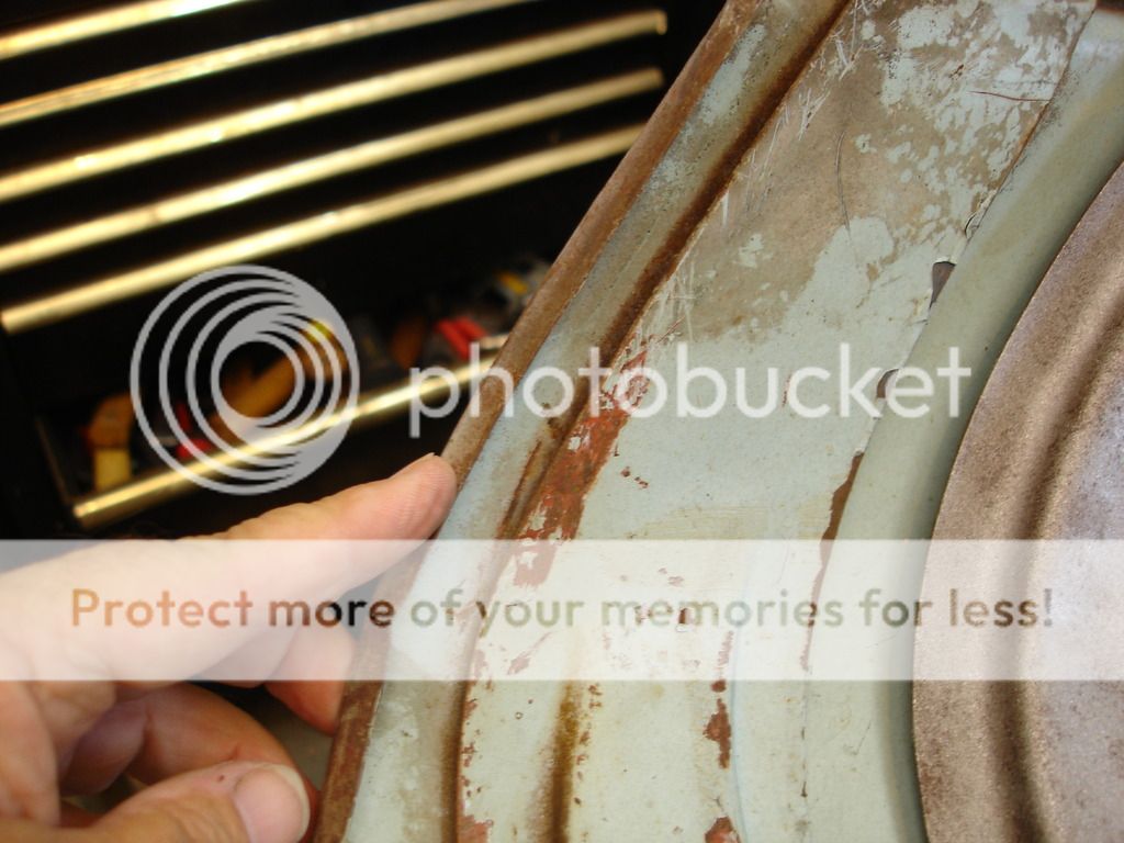

Here are some pics...
This is the TR2 bonnet. No rolled rear edge, making it very flimsy! It does have the 4 vent holes and 2 rivets.
For comparison, this is the TR3 bonnet I have. You can see it has about 1/4" turned downward to add some stiffness to the rear edge of the bonnet. This bonnet is from Marv's donor car, but my TR3A is identical.
I can imagine. I see sheer marks on the edge once the paint was taken off. It looks like the factory just trimmed the edge to match the gap. It is also pretty sharp. If the bonnet ever inadvertently opens...I plan on ducking!
John, Is your bonnet the same length on each side? The bonnet on my January 1957 TR3 is 1/4 inch shorter on the left side of the bonnet than on the right side. I do not know, but maybe this is how the factory got the gap correct at the rear of the bonnet?? It is interesting that you can see shear marks at the rear of your bonnet. Chuck
