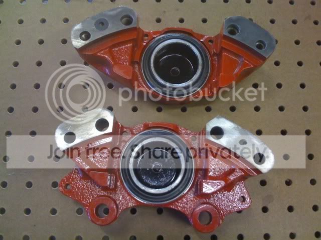

well, after seperating the two halves and forcing the pistons out with compressed air, I hope all works out.I didn't find a gasket between the two halves...don't know if ever one was there.as for the rebuild what about using "copper coat". The o ring around the bore indicates that you don't need a gasket, but just to be safe would an arosal gasket work?
No CopperCoat!
You may be better off with a thin film of Hylomar. As for the piston gaskets, some brake fluid should ba all ya need.
When its time to fit the piston in thru the boot you may find a couple of hooks made from bare 12ga solid copper wire (like stripped house wiring) will help. I flatten one, leave the other round... rounde the tips so they are smooth... and form into little hooks. Helps get the boot around the piston w/o scratching anything.

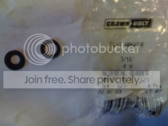

I used a gasket from Lowes in between the halves. I just elongated the hole with a hole punch.
I would not use neoprene either, but hey, maybe that is what Jimmy Johnson uses on his banger racer?
Any idea what temperature neoprene starts to melt at? Or how compatible it is with brake fluid?
I should have stated that the system was completely rebuilt and is using DOT5 in a TR6, when Girling updated there seals from natural rubber they went to Neoprene so the use of DOT3 could be used and would not break down the natural rubber seals, if using the old seals with DOT3, DOT4, or DOT5.1 they will deteriorate hence the use of Castrol/Girling LMA, a vegetable-based fluid. Silicone DOT5 is compatible with Neoprene.
