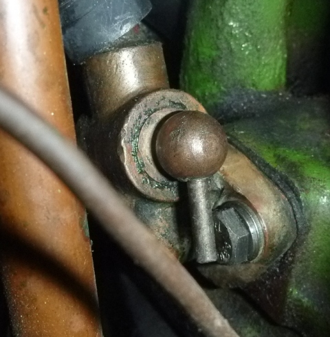

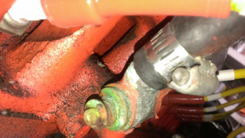

The valve, painted with the engine, can be clearly seen directly above the wire marker on the #6 sparkplug lead. (handle looks broken, but this valve did rotate).

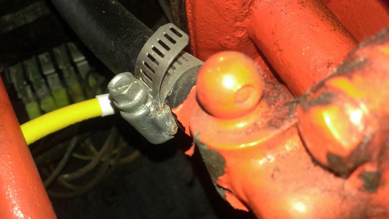

Ok I've located the valve, now another rookie question, is the orange ball in the pic what you turn? Or the other pic and it's missing the handle?

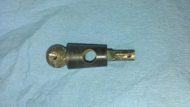

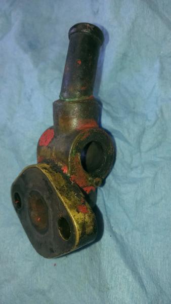

That little valve is a tapered plug valve. The plug runs all the way through the valve body with the bottom end sticking out on the end opposite from the valve handle. The plug at that end has a small spring to keep it tight in the valve body (shown in your second photo). A light tap on that exposed end (and I do mean light) often frees up the valve enough to allow it to be turned with the handle (which I now see is missing).
Now that I see the photos, perhaps it would do to remove the cotter pin, washer and spring from the bottom of the valve and push the plug out. Then you can remove the broken handle and replace it.
I would remove the valve from the engine block and attempt to clean it up, maybe with paint remover. The broken handle can be carefully drilled out. I drilled and tapped mine for 10-32 and substituted part of a longer allen screw (minus the head). The black allen screws are high-strength steel. The valve can now be operated with a cheater, such as a nut driver for leverage.
The "valve stems" are available. The best way to free up the valve is to tap on it as "John" has said. I cleaned up the tapered stem, applied a little grease to it and reassembled it with a new handle. I think I must have about six valves for 100's and 3000's in a coffee can that I will repair some day when I have the time.

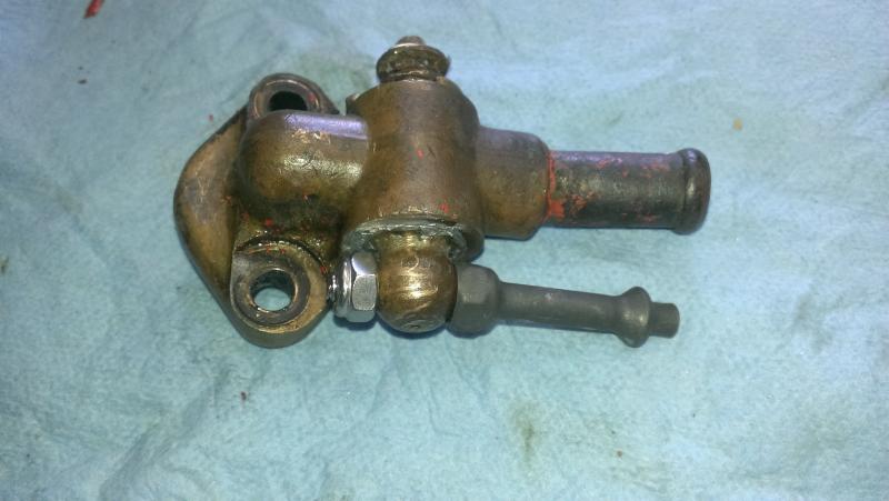

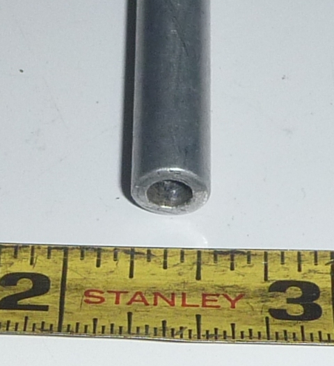

Well I repaired my heater valve today using the advice I got off here. My cotter pin disintegrated when I tried to pull it out and I had to drill it out.
I used a ez out to remove the broken old handle but buggered up the threads while doing so. I ended up drilling it all the way through and re-tapping it, I used a 10-24 bolt with 2 nuts to secure it in place. To neaten the handle I used some shrink tube to finish it off. Works great now and the cab is cooler.

I've had mine off a few times and, surprisingly, almost no coolant came out.

The engine was cold and the thermostat was closed. I probably had a cork handy to put in the hole and may have plugged the heater hose as it was removed from the valve. Just saying it was not necessary to half-drain the coolant from the engine in order to remove the valve. Easier to just deal with a small amount of leakage coming from the hole.

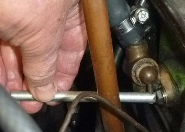

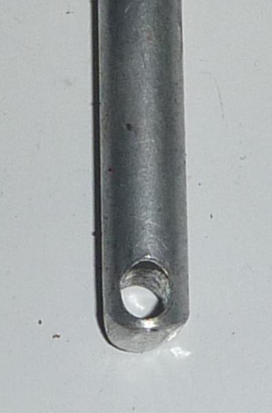

as usual one elegant tool, from Steve-
probably is plugged the little hole of the valve---a new baling wire tool?in Italian "Fil di ferro"
