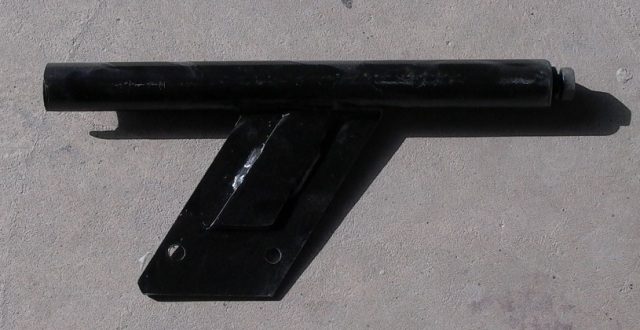

My body guy made up brackets - I can likely scare up a picture they just bolt directly on the front of the "frame" (where the tow rings are)

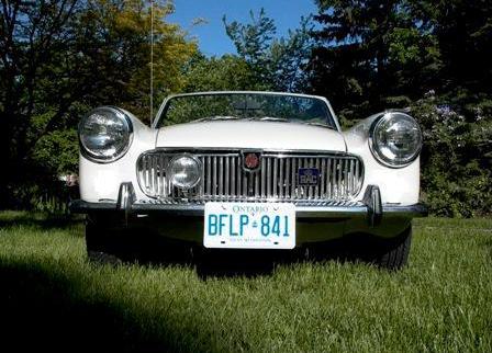

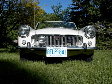

What would you do with the original mounting holes? I'm trying to imagine them filled in and what that would look like....
just like that - no side signal lights or rear reverse lights either :laugh:

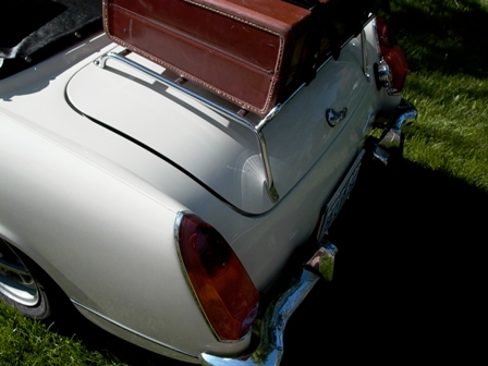

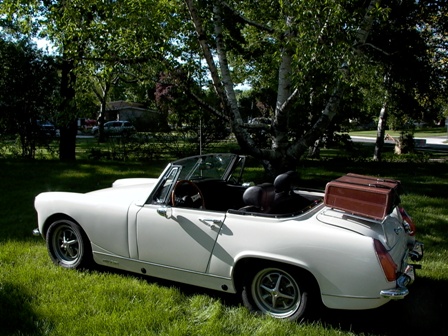

and the back
Much much nicer.
Found the picture of the bracket I had fabbed - the end is a nut so a bolt screws right in
That did come out nice. I'm tempted, but I'd ~HATE~ to cut my car, plus, I drive it everday everywhere and need my rubber bumpers.
What's the deal w/ the rear lights, will early lights fit late cars?
yes they are all the same - I should have got the old ones and will one day
