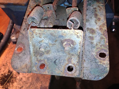

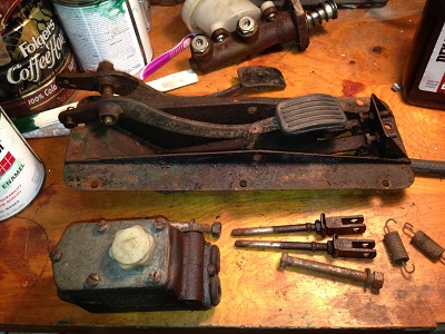

I finally had some time on Bugsy 2 yesterday and did some time working on Sub Assemblies that need to go out for rework. Dual Master was extricated from the pedal box. It didn't want to come out without a fight. But PB Blaster and a few taps with the rubber mallet got it out so it can get on it's way to Gerard to be resleeved as a 3/4" Master. Rest of the parts, springs, pushrods, et al need to be subjected to some electrolytic rust removal to see if the rusted parts and pieces can be cleaned up and made salvageable. The pivot bolt for the pedal box is all knackered up on the threads for the locking nut. It appears AH Spares sells a replacement for 6.5 pounds. Time to figure out what else I'll need to get shipped in the same box.

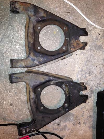

I also pulled the wishbones apart, removed suspension buffers, and they are on the way to Apple Hydraulics to get new metal bushings brazed in. You can't see it on pictures but one of the bushings is worn on the inside such that the fulcrum was sitting off center. Threads trashed and no way a new fulcrum pin would screw in there. For just over $200 Wishbones will come back in a week, sandblasted, straightened as needed, new bushings brazed in, and primered and ready to be reassembled. Careful examination shows no cracks or issues. If you are thinking about getting this done, carefully look at the undersides of the wishbones. Inadequate greasing at regular intervals cause the fulcrum pins to sieze up in the bushing and cause cracks in the A-Arm. I spent an entire afternoon 2 years ago giving up lots of pieces of skin and blood pulling a set of A-Arms out of a Spridget going to the crusher. When I got the parts home and removed the grease I found both A-Arms cracked and unrepairable. The fulcrum pin rotating in the metal bushing is the key wear point in the front suspension. For an extra $5 you can get a 2nd grease fitting installed as well.
