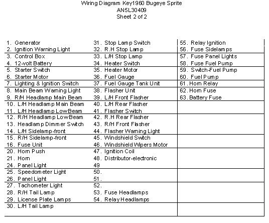

Just to let you know, there are two different types of wiring diagrams: one is a schematic, and the second is the wiring routing diagram.
The Schematic is the one usually found in the shop manual, although it is a hybrid. It lays out the electronic components (usually in a layout similar to where they are in the car) and the interconnected wiring. It identifies all the components and the colors of the interconnecting wires. It usually does not indicate the guage of the wires. In making many revisions to a BE harness, this is the place to start. At this stage, don't worry where the components are on the drawing.
Once that is complete, decide where you want to mount the components. As you say, can't I mount the oil sense switch inside at the dashboard? At this stage, the decision where to put components is mainly a decision what the car will look like, how easy will it be to service, and how easy will it be to wire. At this stage you need to account for current draw, guage of wires and to decide where you want to put the fuses and relay and other non-original BE stuff. As you can see above in my earlier post, I wanted the BE to look original. Once that is done, it is a matter of making the harness to scale, which traditionally is done on a flat board with a series of nails for the transition points. Good luck.
(Wiring diagram attached) Scott in CA

I do not recommend installing an ammeter. It requires large gauge wiring, and any problem with the ammeter can cause the car to shut down. A better choice is a voltmeter, which is installed from the ignition switch to ground. Uses small gauge wire, and is easier to read. Car running voltage should be 13V or more, 12V, something is wrong.
I see no problem with using a tee behind the dashboard, other than when the oil does not stay in the tube, it goes all over you, the carpet and your passenger. Less places for the oil to run out with just one device.
Good luck
Scott in CA.
