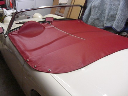

I used a leather punch set from HF, made sure the cover was warm and flexible (leave it in the sun). I used blue painter's tape and marked the center and location of the snaps. You will need the two 1x1/8" flat bar for the the rear hooks. I attached it at the back, then centered it, and put in the front snaps. Then installed the side snaps. BTW, there are two type of tonneau covers for a BE. One which hooks to the top brackets in the back and the shorter one which snaps to posts along the rear edge of the cockpit. The long version is more common. I wanted to jazz up the colors of my BE, so I ordered the red color from AH Spares(they provided samples which matched my Moss seats).

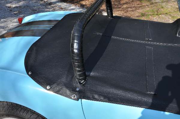

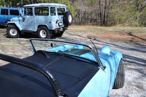

Pretty easy. Take your time. Warm sunny day. Let it all warm up
first.
STRETCH....everything. Two guys helps. Bluemax helped me.
Those punch tools help but you'll still need small scissors
and a sharp knife. Those little Swiss Army pocket knives are handy.
The "shorty" tonneau needs additional studs along the back of the cockpit.
I had those removed and the holes filled. I like the long version. I had both styles.
I had a shop do the roll bar cutout and edge that modification
before the installation. They charged 20 bucks.
BlueMax and I installed the thing in a couple of hours or so.
Taking our time.
