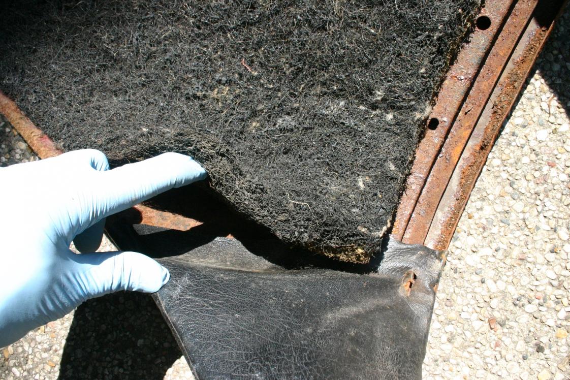

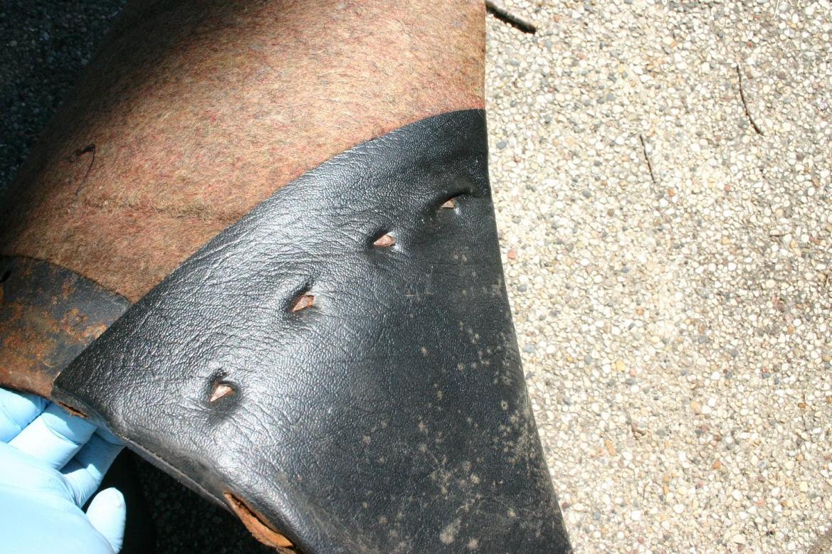

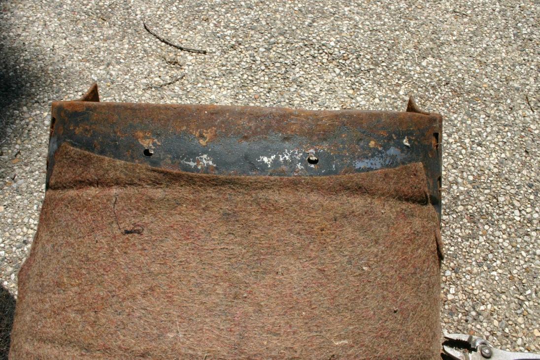

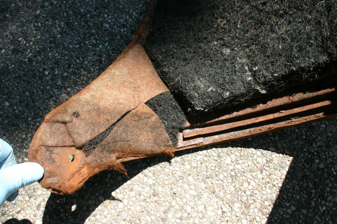

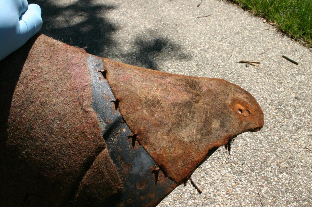

I'm at exactly the same point with my bugeye upholstery. While I believe I have the right idea, I'm still a bit wary of actually installing the covers. Here's what I have:
The black seats are what remains after my wife and I recovered them in 1973. She sewed up the covers and I put them on, so the install is not original, but probably followed the original. The horsehair underpadding was salvageable after a lot of disinfecting. New felt was used and new covers came from AH Spares. (I bought the car back after 38 years.)

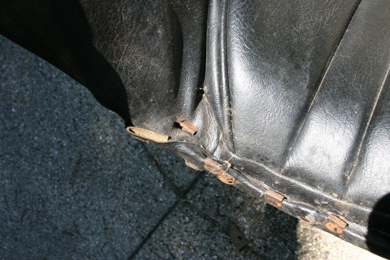

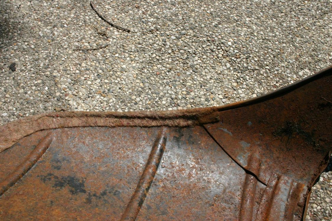

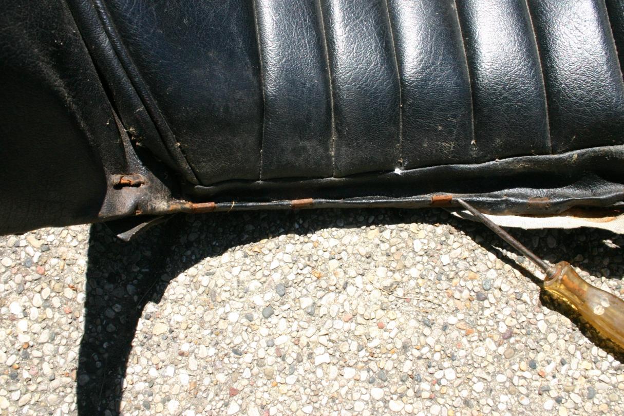

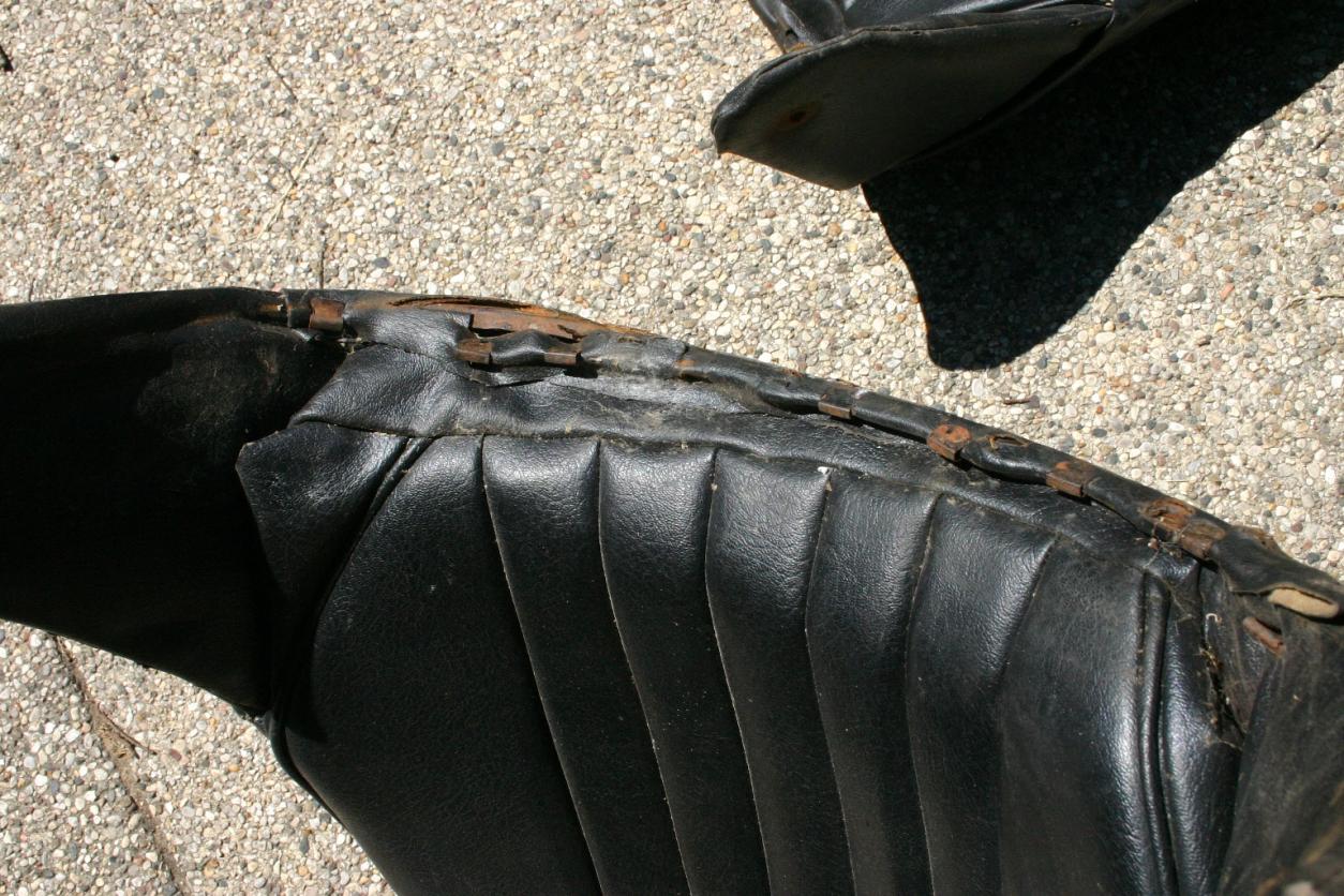

Looking at the pictures will disclose there are two sizes of metal clips. The narrow ones, for a single layer, are for the front of the cover, which is pulled tight and clipped on first. The large clips are installed second when stretching on the backs. They go over the back fabric as well as the front which is already clipped on. Moss' catalog shows the two clip sizes.
The one picture with the pick in it shows the small clips over the front after removal of the large clips and the back fabric. The back side photos clearly show the wider clips.

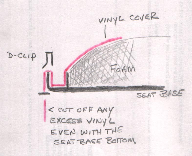

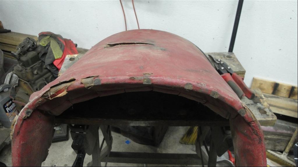

The red seat pictures were found somewhere; that install looks original. The diagram came from someone here, I think.
There is also a very good pdf, which is the best explanation I found. It apparently is too large to load but I can send. I also can't seem to fix the order of the pictures.
Jim

David, pictures 55,56,and 57 are exactly how I had pictured it being done. The trick will be making sure the seams line up from the back to the bottom. I also had to rebuild the lower edges of my backs, I have a shrinker/stretcher combo though and did each one with two pieces of metal. I'll post pics for the next guy who comes along searching for ideas.
