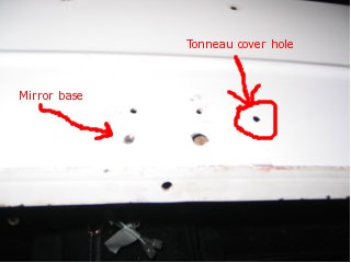

On the Tunebug, the mirror is held down with 2 machine screws (10-32, with captive nuts). This is a LHD car, and there is a hole in the dash to the right of the mirror base for a stud for the tonneau cover.
I've circled the hole in the picture attached. The pair of holes closes to the edge are the original mirror mounting holes.
Edit: updated pic with better captions.

That is not correct Ben, the rear view mirror is held down with two chrome bolt screws with dome shaped heads. The tonneau center is held with a lift a dot fastner, try a boat supply place for nice ones.
The "lift-dot" studs through the mirror base are definitly a PO modification!

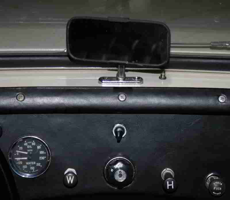

ncbugeye is unrestored, unmodified (except under the hood) and looks like this:

Well most Lift-the-dots have a 10/32 thread as does the original mirror screws so someone just used the studs as screws. I guess it makes sense, no extra holes for the tonneau. BUT do you have THAT tonneau? If so, any marine or boat shop stocks 10/32 stainless lift the dot studs but they do come in sheetmetal, 8/32, and metric threads. Make sure you get a 10/32.
Ben,
Short with cutouts for the rollbar.
