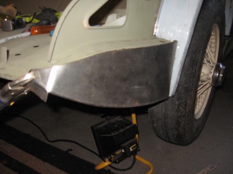

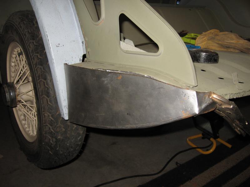

Needing a bit of help understanding how the rear quarters work. Penny Bugeye's had some repair work done on both sides in the rear quarters, and it's not good work (and all rusted now anyways). In some cases there are what look to be a couple panels making up the inner structure, but it's not entirely clear. The Moss catalog shows one inner panel per side.
I could use some insight here into how this is supposed to go together correctly. Any pictures of repairs in progress would be wonderful.
What we're facing:

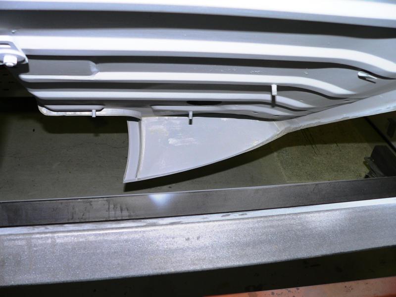

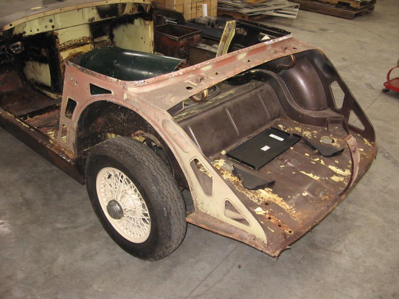

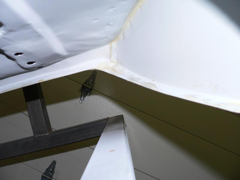

Here are some pics from my Sebring project that show the inside panel which is available from AH Spares. Although this car is a '68, I have removed the floor extension piece that returns the floor to a bugeye shape as seen in the early non sand blasted picture. This panel fills the gap between the floor and the Q panel, tacked onto the Q panel and connects to the rear floor as well, completing the corner. Hope it helps.
The grey wheel arches are the new bugeye wheel arches welded on.
Cheers
Lew

It looks like Penny's previous "restoration" did the same thing on the inside that they did on the outside -- left the old, rotted metal in place and just slapped a new piece over it -- so there are currently 2 layers of inner panel just like there were two layers of outer panel. That's what was confusing us.
Looks like you have your answer Drew. Just confirming one outer panel and then the "closing" panel on the inside. BTW, the lower quarter repair panels require a fair amount of work to fit properly. The shop should measure the opening from the front of the wheel opening to the leading edge of the repair panel. I believe the length of the opening from edge to edge should be 25 inches (maybe have someone measure theirs and confirm). I'm sure they will test fit the panels but just let them know they are bound to need modification.
