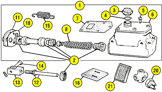

At about that time vacation and other time drains kept me away from the car. When I went back I discovered my "rebuilt" master cylinder was leaking at the joint where the top joins the body of the MC. (Item #7 on the picture below.)

First, is the leak at the top plate to the MC body a typical leak point and will a new gasket be the simple fix or could this be an ongoing issue unless the mating surface are cleaned up. (I haven't removed the plate yet to assess the mating surfaces.) Is this a dry fit seal or should some form of sealent be used?

The to-plate-to-body joint should be easy to seal up; just be sure everything is flat and clean, put in a new gasket, and all should be well. I'll bet some gasket material was left on one surface or another. Just scrape it smooth, check flatness with a metal ruler. Of course, be sure the screws are tight but not overtightened.
