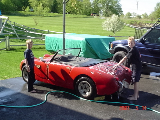

Woo Hoo! I finally got the BE home today. My boys were at first skeptical, but once they saw the smiling face I think they like it now and helped me give it a much needed bath.
It does look like I have a ribcage transmission, the bad news in addition to all the bubba wiring is that the 1275 is seized. uggg. I poured some Marvel Mystery oil down the bores to see if that helps loosen things abit.
On to the fun!

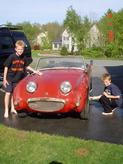

That looks like a good one! You have a decent looking chrome grill! (that can be expensive and/or hard to find!) The siezed motor will make a nice "project". Looks like she has a bit of a list to port! Your boys will LOVE it once it is on the road, I know mine did! /bcforum/images/%%GRAEMLIN_URL%%/thumbsup.gif
Mike unfortunately the grille is toast. Also, it doesn't look like it has the original grille insert, something more akin to a fancy screen door! lol!
Looked good in the pix!! Sorry! I also am keeping an eye out for a decent one! Jack is the lucky guy on that score!!
Just looked at the pic. again. It sure looks to be an original from what I can see! Is it all one piece? If so that is a Sprite grill! They can be re-chromed nicely if not too bent up and pitted
What kind of shape are the floors etc. in?
Mike, the grille is pretty bad pitted.
