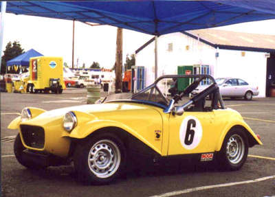

haha, no, I know exactly where it ended up. I still have pretty much all of it except the shell itself. I still have the bonnet and doors, and everything else which will go on the one I'm currently restoring (if I ever get to finishing it) The shell was sold to a guy in the Portland, Oregon area along with an 1970 Arkley Midget, which he turned into a race car. This was the late 90's. I'm not sure what became of the Bugeye, but after seeing what he did with the Arkley, I'm sure it's running around somewhere. I know he sold the Arkley to someone else (I came across it years ago), and likely the Bugeye eventually had the same fate.
You can see the Bugeye shell in the background.
That sound's exactly like mine, Gerard! Your first BE didn't end up in Nebraska did it? With a "Save water, shower with a friend" sticker on the passenger door!:yesnod:
