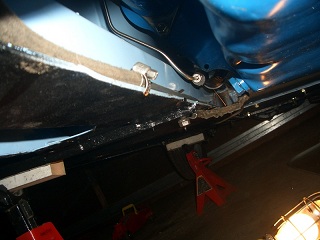

I am running the original mechanical stock fuel pump and what I think are original gas lines. The steel line runs from the gas tank and stops at the front right corner. A rubber gas line from the right front corner then heads to the left side of the car where it connects to a steel spiraling gas line that drops down on the left side. Another member warned me that I should reconsider the rubber hose connection because it is below the level of the line at the gas tank. He mentioned that this is a potential fire hazard since if rubber line fails the gas tank would be siphoned out quickly. So I have two questions; 1) Do I have the gas line routed/hooked up correctly? 2) If it is correct, do I have a reason to worry about this, and what could I do to make this safer? Don't know if the pics help, but here is a shot facing toward the back of the car on the passenger side.

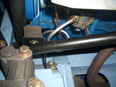

And here is a pic on the left hand side of the engine showing the spiraling gas line. Any help would greatly be appreciated,
Kevin
Kevin,
I just checked with a friend who has a concourse level, restore to original car. Just as I remembered, there was never any rubber in the original fuel line. If you want to use a rubber section, just make sure it is above the level of the tank to eliminate the possibility of creating a siphon.
Gerard
Thanks Gerard. What's weird is I have a second bugeye with the same set up. Never understood why there was a break in the line that way. I seriously thought about getting a stainless steel line anyway. There are three areas where the old gas line rubbed against something and is thin in those areas as a result.
Kevin
if they're rubbing, just change to an all steel line or just exchange the rubber section with steel braided teflon hoses.
What bothers me more is the solid steel line to the pump.
Even "spiraled", there is flex in the motor mounts and road vibration (and inherent LBC vibration).
If it was my car, it would have steel lines to a bracket on the frame near the pump, and a rubber hose from there to the pump.
Just saying.

I am trying to keep things as stock as possible as Bill mentioned. However, I do have the same philosophy as TOC. Safety takes precedence over originality. For instance, my car came with lap belts, but I now have three point belts. I know I have little experience so far, but I have found when done properly, this car seems to have been designed well. Most of my problems center around previous modifications I was not aware of and had to correct. The main reason I am going to a solid fuel line is (as a number of you pointed out) is it is much safer. Thanks again to alerting me to the non stock information as well as the safety factor everyone.
