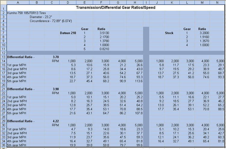

Hap Waldrop said:Hopefully Ray MCcaleb is reading this, if I'm not mistaken he plans on running a 3.7 with the Rivergate 5spd, that sounded like too tall of gearing with the 5 speed, but I have no experience with the 5s pd., maybe you guys can shed some light on this for Ray.
I've done a little research on this before making the decision and put together a spreadsheet that helped in the decision making process. I offered it up once here on the list...unfortunately the discussion evolved into hypotheticals (environmental variables, etc.). Never the less, leaving wind resistance, humidity, and planet alignment OUT of the analysis and using the strict givens, engine rpm, transmission ratio, diff ratio, and tire size, the chart tells me that with a Rivergate 5-speed (Datsun trans.) and a 3.7 rear end, the final drive ratio (which can be inferred from the relative MPH column) will be slightly less in first, second, and third gears, equal in fourth (1/1), and greater in fifth than with the stock transmission (4 speed) and the 3.7 or 3.9 diff. The stock 4-speed and the 4.22 diff would yield a lower speed (higher ratio) in all four gears. Keep in mind, however, that production street cars with the 4.22 were only produced with the smaller displacement engines installed, not the 1275.
Fact is, I have one each of the common differentials (3.7, 3.9, and 4.22) and will experiment with each until I find the one that best suits my driving needs.
Here's the chart...pretty small to fit here, but you can save it off and open it with a viewer that can magnify.
