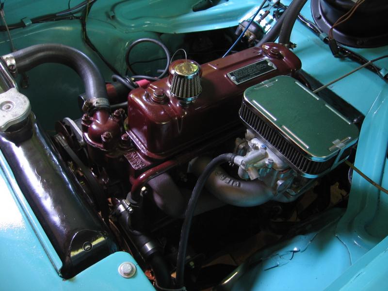

How about this--on my Nash Metropolitan--filters the outgoing contaminates, and it looks (to my mind) better than a hose hanging down--
