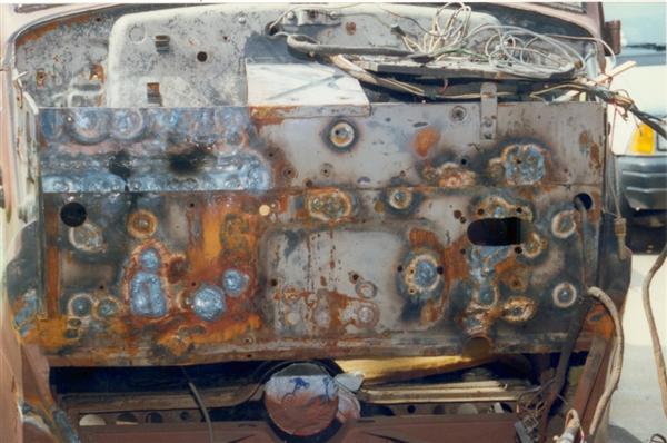

Never tried one but it looks a little gimmicy. Best luck I have had is just the old acetylene torch and a regular hammer with backup. Just takes a lot of patience any way you go. Had to fill 40 or so holes in the Prefect firewall then lots of shrinking to get it flat again.

40 holes in a Prefect? was it Target practice?
Did you use a MIG when filling those holes? I've found that it is very difficult to work the HAZ once something has been MIG welded.

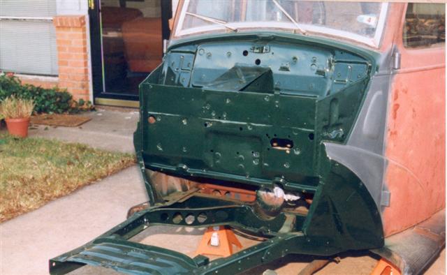

JP, I don't even have a guess as to the reason for all those holes. I probably put a few of them over several years of "customizing or adapting." I don't have a MIG welder so just used the acetylene for both the patching and shrinking. Time consuming since I'm not a qualified welder but still gratifying. Here it is finished in BRG Deltron.

Impressive :bow: Not wanting to hijack the thread too much, but, last year Mark (Abarth 69) & I took a welding course which just taught us enough to be dangerous (well me at least - really) Anyway, once I get the time to start working on Luigi the Multipla, part of wonders if I would be better with oxy-acetylene than MIG. I know MIG is easier from a time/just do it point of view, but, you end up with something much harder than with a torch. I was also able to get a VERY small flame with the torch - which was slow but worked. Any thoughts?

Correct, A MIG is quick and thus you do not have a large HAZ, but the weld itself is very hard to work. The oxyacetylene method is slower, and can cause more warping, but if you now how to normalize and push the metal by hammering as you patch the result can be much better. That firewall is a good example.
As I said earlier, I am far from an expert. I have a friend though who restored an XK140 for another friend that was even too far gone for the crusher. He is good enough that his main job is repairing sheet metal on million dollar vintage racers. Anyway, on this 140, he was offered a nice MIG unit and used it a bit. For 90% of the body work, he still stayed with the ole torch instead. Said it was just easier and quicker than having to deal with that MIG seam.
