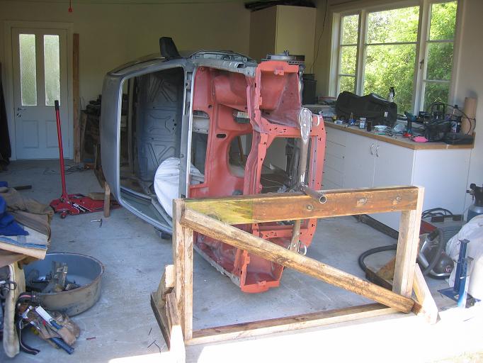

Fred,
All striped down the car can be picked up by two guys. With four guys it turns over quite easy. I finished the complete under side and the lower portion of the body then turned it back over. I then assembled the complete car on the cart jacked it up and rolled the cart away. If you make a cart get locking casters I didn’t and chased the car all over the shop and drive way. I made the cart out of the wood scrap pile and it could have been a little stronger it started to sage with the completed car on it. The car is so much easer to work on up hhigher.
I never liked the idea of rolling it on its side.

I have a junker I am needing to redo floors, can you roll the car on its side on top of a mattress and not damage the side of car while you work on the bottom, Yes I have a ansewer for fire risk.
I suspect you can roll it easily (just don'e hold me responsible) seriously, the metal is pretty thick and the curves will hold the shape.

JP,
I was thinking of something similar to that, but picked up an extra 1k pound HF engine stand for $35. The foot print on the stands has me concerned, but they are somewhat mobile. I really like the simplicity of the wooden rig though...4 tires and a bottom brace?
Rut
you could perhaps add a couple 2x4's perpendicular to the existing footprints - if they function like sponsons, (just above the floor surface) you could still move the car but if it tipped, the wood would keep it going over. Engine stands will work just fine, just make sure the two stands are attached if you want to move the car - don't ask me how I know. Again though I suspect a 2x4 would suffice.
and yes, 4 tires will work just fine.
