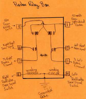

Make sure you have good, clean, tight connections on all connections such as trafficator, bottom of steering column, turn signal flasher, and the relay itself. Then in an operational test make sure you have good voltage at the relay coil terminals. Numbers 8 & 4. If that doesn't cure it is seems to me you are in for a new relay. Oh also make sure you have a good ground connection to the relay.

I'd refer to Vette's drawing above and run a jumper directly from the hot side of the fuse box to the terminal in question. If it functions perfectly, the problem's in the wiring between the trafficator and flasher relay. If no different, then the problem's in the flasher relay.
