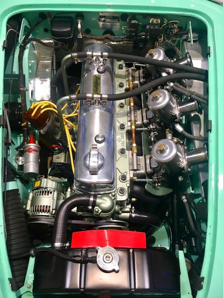

No, Jeff at Advanced Dizzy built me a Lucas race unit similiar to what was used on the D type without vacuum advance. In addition, I use a Pertronix II ignition with the Pertronix Digital HP management system.
