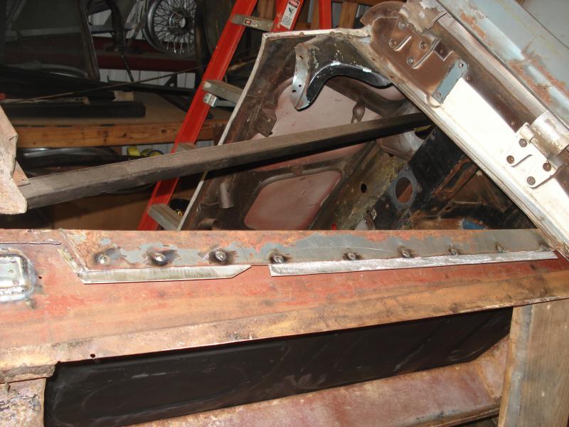

I simply welded in square tubing at a diagonal from the firewall to the rear floor corner when I did ours. It held the dimensions just fine. When I was done and certain all was still good, I simply cut them out and ground the welds down. Be sure to allow the doors to be put on so you can constantly check gaps during your sill replacement.

Thanks for the info, it now gives me the way ahead.
i will jack the car complete with major components onto its suspension points and then brace it with square tubing as described.
