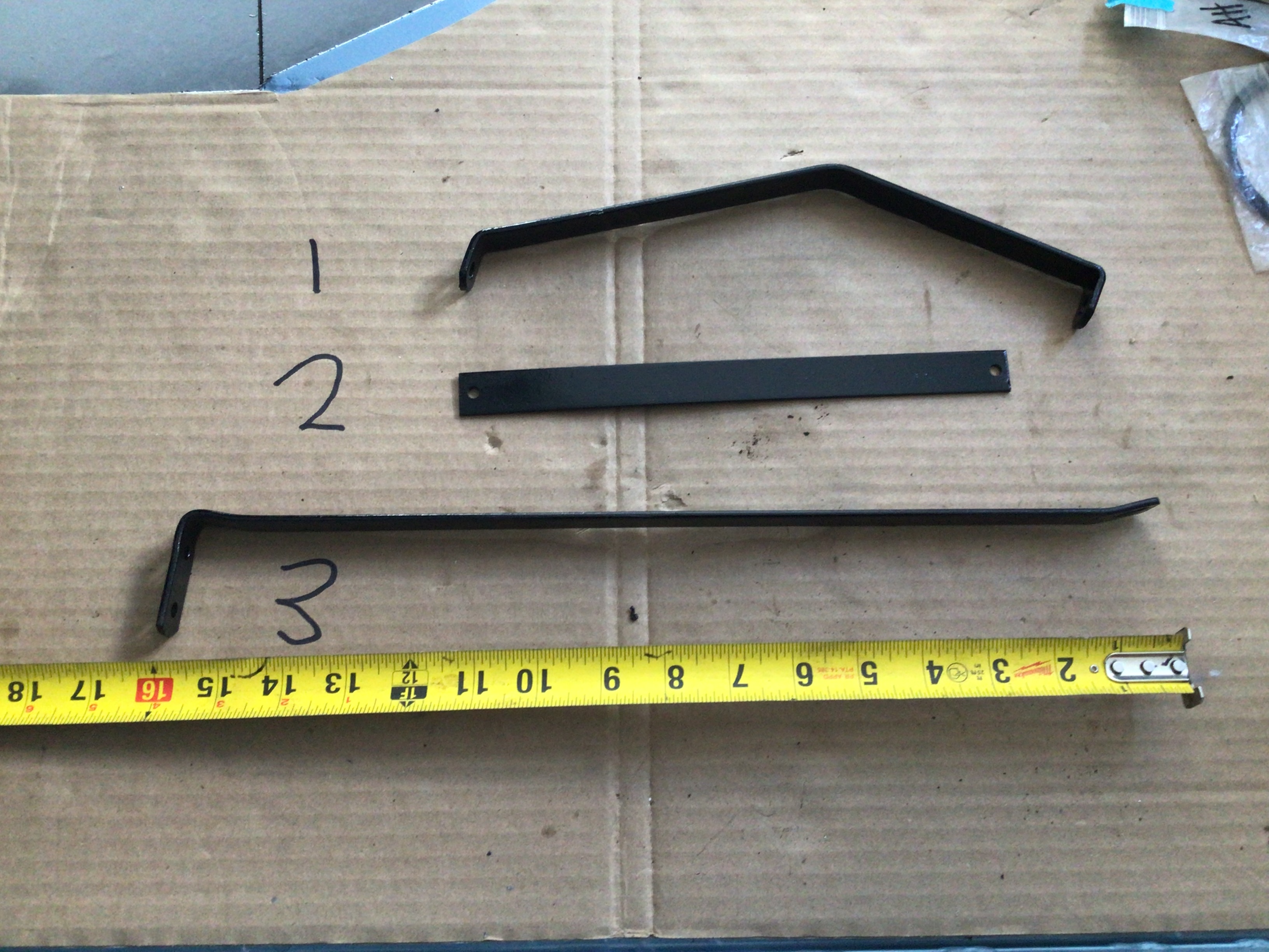

#1 is brace from steering column aluminum clamp to windshield mounting bolt
#2 is brace from tab on scuttle down to parcel shelf (a little to the right of heater box)
#3 is brace from dash bottom to heater cross tube (a little to the right and below the steering column)
