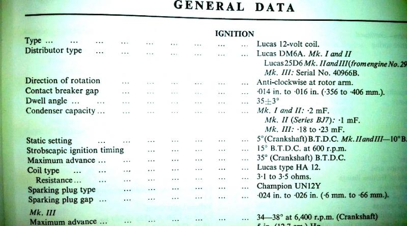

looking to confirm what the timing should be on a 29E series engine.
my one manual showed ignition timing on BT7's as 10* BTDC static and 15* BTDC with the light.
in another manual it says only on 29F/4898 and later engines use the above settings. the earlier cars use 6*BTDC static and say nothing about a strobe light.
i just want to make sure i set my car properly.
Thanks
