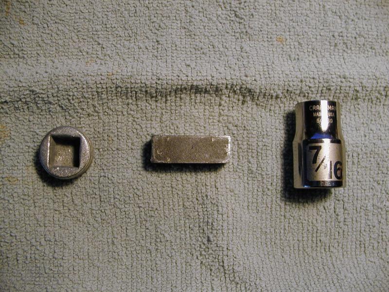

I just use a 3/8" socket wrench handle.?

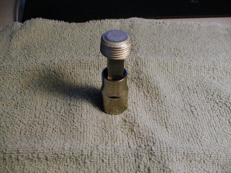

It's 3/8. Fits, but loose. I bought a 7/16 bar stock and cut a short piece, but it needs to be filed down a bit to fit the fill screw. Just looking for the real thing, or what will work. That screw is in very tight.
Paul,
7/16" square stock, 8 point 7/16" socket!
