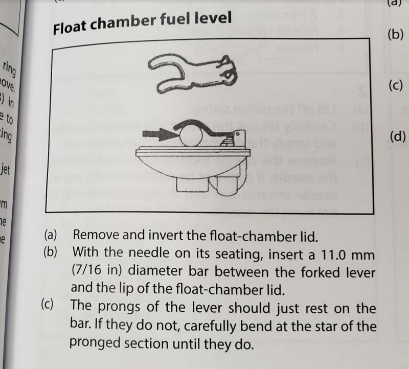

Ron - you're right about the Bentley manual. I had thought it was less ambiguous than that.
Burlen's current SU Workshop Manual, Section "HD Type Carburettor: Routine Servicing", p. 21:
In previous threads some advocated a 5/16" float level as well as a float level based on the fuel down (IIRC) 3/16" or 5mm down from the top of the jet. The latter resulted in a 5/16" float level anyway. I ran 5/16" with my dual Air/Fuel Ratio gauges and noticed no difference between that and 7/16" - so I went back to the factory recommendation.
