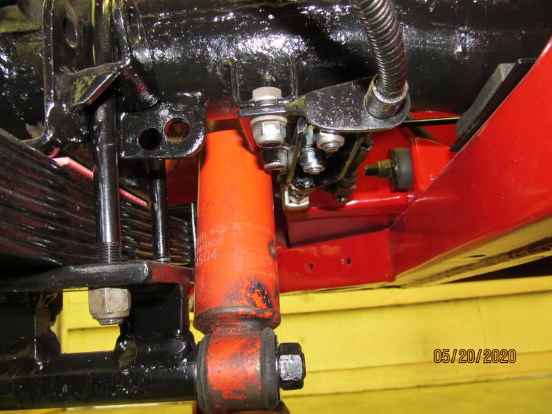

I'm curious why you treated the left & right brackets differently? Seems like they would have the same weight load, same spring rate, and same shock resistance, so the same deflection loads?
Did you find that the left one didn't need the stop bolt, so went with a simpler gusset? Or were both gussets added after your first trial - one with the stop bolt and one without? Inquiring minds want to know.

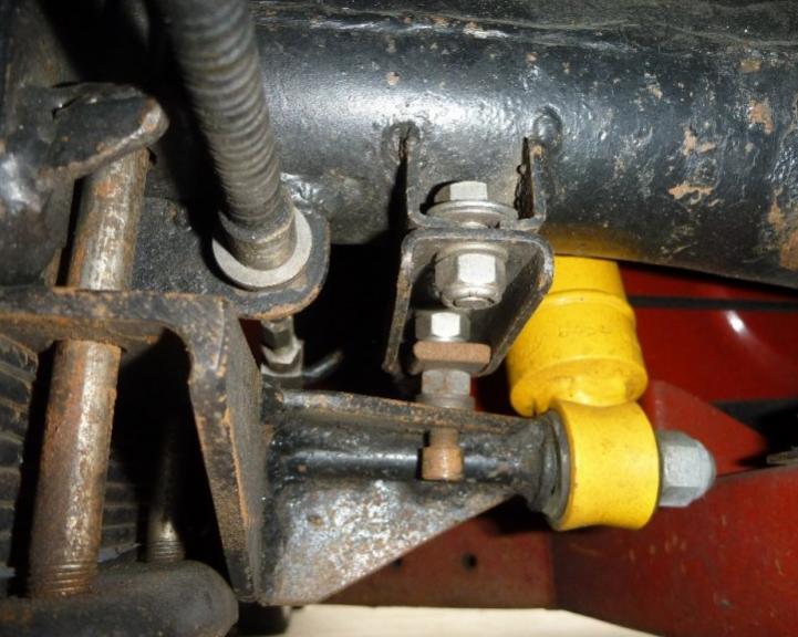

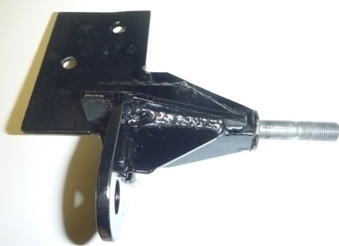

I expect your shocks are too short, but if you have any more length, you might want to make brackets like the Konis I show above, they have their own bottom plate with a 1" bar turned down at the end for the shock that extends across the bottom plate and is welded most of the way across, thereby taking advantage of clamping by both ubolts and no need for the plates to resist bending.
