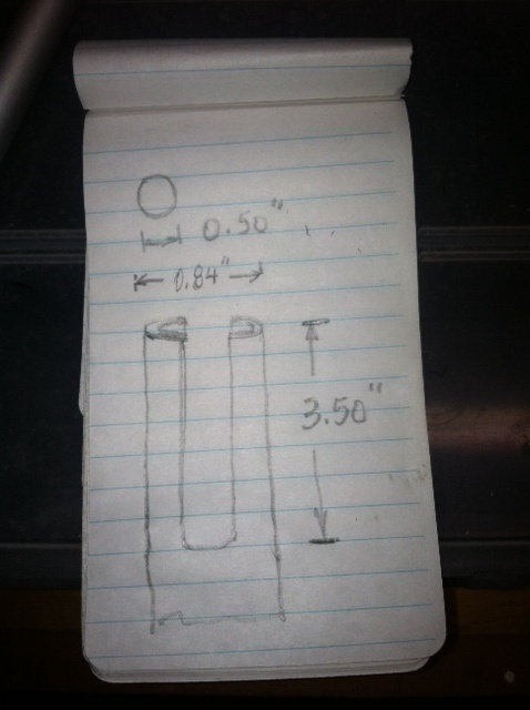

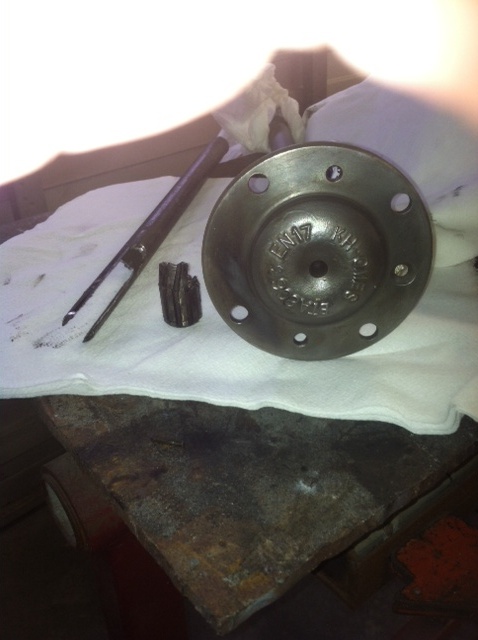

In a fit of inspiration (or maybe desperation), I fabbed this tool from a piece of Sch 40, 1/2 pipe. I drilled a 1/2 inch hole at the upper end of the slot and then cut the slot with a die grinder.
The slot in the pipe fits around the pin in the carrier and allows the broken piece to be driven out the other side. A few whacks with a ball pein hammer and the offender popped free. The axle remnant was not just broken off, but sorta fractured or split, which explains why it was so tightly wedged.
In the foggy recesses of my mind, it seems as if I've seen this technique before, so I'm not going to take full credit.
I bought a couple of used EN17's off of Ebay, so I hope to be riding again this weekend.
